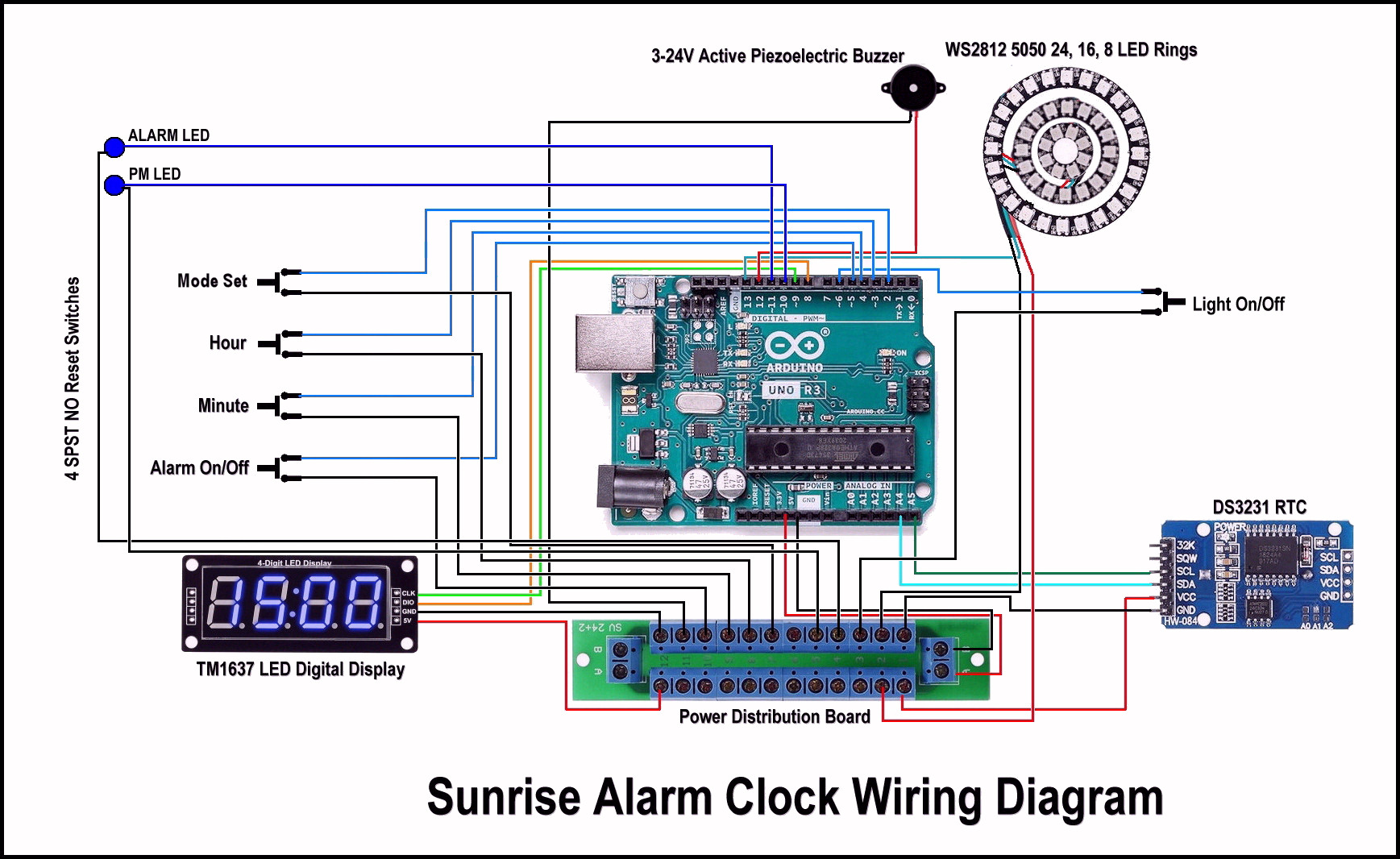

My latest project is a combination sunrise alarm clock with bird chirping and table lamp. The case was cut and engraved with a Scuplfun S30 10w laser. The top is an antique Hemmingray 42 glass insulator. The circuit is shown below. Works great!
Looks great!
I suppose that's steampunk.
