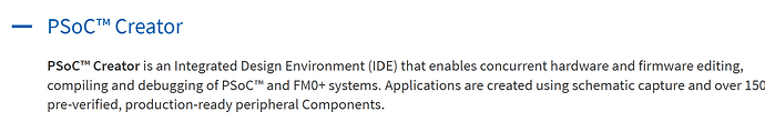

I am a fan of Cypress (now Infineon) methodology:
  • library code is automatically copied once into the project folder and all #includes reference the local copy. If library and local become out-of-sync, the programmer decides whether to update the local copy - like a galactic shield from the Adafruit constant re-architecture Flux.
  • The IDE builds a project overview (executive summary) with each software build as a nicely formatted PDF.
  • The IDE keeps a roll-back version automatically in Zip format.
With most new PCs coming with 500G to 1T or larger hard disks, it is nice that the IDE enforces automatic backup and sensible roll-back options.
Once you get your head "around" the PSoC concept, it is a joy.
https://www.infineon.com/cms/en/design-support/tools/sdk/psoc-software/
Edit:
Cypress is now Infineon, but the PSoC "Cypress" dev boards are being still sold at one distributor - Digikey
