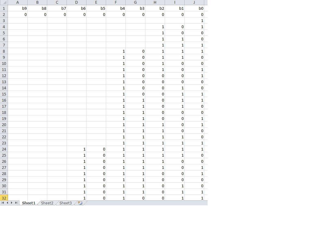

I have two TRD-NA1024NW units. Both of mine appeared to be doing something similar to yours at first glance. But closer inspection of the data reveals something different.
For my two encoder units, I start at 0000000000 (10 bits). With the top of the encoder shaft facing toward my eyes, I rotate the dial clockwise (relative to me) with my fingers, and I get 0000000001, then next value is 0000000101, then 0000000100, then 0000000110 .... which are decimal counts of 0, 1, 5, 4, 6 ...
Then I go back to the zero position, then rotate the dial anti-clockwise, and I get 0000000010, then get 0000000011, then 0000001011; which are decimal counts of 0, 2, 3, 11 ...
Attached is a screenshot of bit value results I'm getting as I slowly turn the dial clockwise.....
My spreadsheet is attached too. Even if I re-arrange the bit columns, the pattern doesn't seem to correspond with usual gray code. Eg ... if I switch the last four columns around to try get a 3 bit gray code... we get...
000
001
011
010
110
111
The next value 'expected' for gray code would be 101. However, for my trd-na1024 units, the next value turns out to be...
1111 (4 bits).... ie the fourth bit kicks in.
I attached my spreadsheet in a zip file as well.
Colour codes on my wires match up with the manufacturer details....

Anybody else here using the TRD-NA1024NW? Are you getting proper gray code bit values instead of the stuff that I'm seeing?

Thanks Tom! Yeah....I know how gray code works. My encoder appears to be changing by 1 bit at a time, but not in usual gray code style.
I've only mapped out the first 31 positions (manually, for now).
I was assuming that the 10 bit encoder would output the usual gray code pattern.... such as:
(a typical gray code pattern below)
0000000000
0000000001
0000000011
0000000010
0000000110
0000000111
0000000101
0000000100
0000001100
0000001101
0000001111
0000001110
0000001010
0000001011
0000001001
0000001000
0000011000
0000011001
0000011011
....but my encoder isn't following that pattern as far as I can see so far. But at least the patterns for my units are changing 1 bit at a time.
I will later hook up the encoder to a stepper, and do some microstepping..... and see if I can map the rest automatically.
The encoders I got (two of them) are TRD-NA1024NW .... meant to be 10 bit, 1024 position to cover one revolution. Manufacturer specs mention 'gray code', so I'm assuming the bit pattern (when wired correctly) should follow the usual gray code pattern. That isn't the case for my two encoders.
The description of what I'm seeing with the TRD-NA1024NW 10 bit (1024 position) absolute encoder is at ....click here.....
Also, interestingly - my encoder pattern is following the 1-bit change pattern discussed at:
...this link here.....
which is... 0000 0001 0011 0010 0110 0111 1111 1110 etc.

It does look like a Gray code, but the bit order is different than the example shown in post #15.
If all allowed 1024 bit patterns show up, then it must be possible to remap the bits to follow the pattern shown in post #15. Just swap the wires around.
