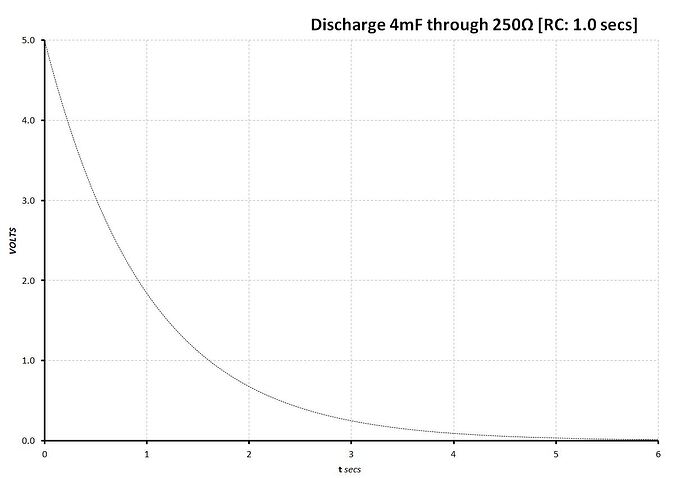

As suggested you first need to know
(1) the approximate current drawn (I) by the nano from the 5V rail. If you have a multimeter put it in mA mode in between the diode and 5V pin. I'm not a nano user but I'll assume 20mA for now.
I would also read the nano specs to find out:
(2) how much the 5V can drop (delta-V) before the nano stops working. For now let's assume it can drop down to 3V before the nano stops functioning, i.e delta-V = 5-3 = 2V.
Finally you need to know:
(3) how much time it takes (t) to write your critical variable values into EEPROM. I would write a test sketch with temporary start then stop timing sequence to write the typical 200 values to EEPROM. The time (t) won't be very long time, I'm going to assume this takes 500 milliseconds = 0.5 seconds (I'm not a nano user but I reckon it will be much faster).
So the capacitor has to be large enough to satisfy these numbers:
I = 20mA
delta-V = 2V
time t = 0.5V
let's have a go at working this out .... we need to detemine an approx value for the input resistance (R) at the 5V pin. From equation V = IR we know R = V/I so 20mA at 5V implies an input resistance of R = 5/0.02 = 250 ohms.
Now in a simple circuit where a capacitor discharges through a resistor the voltage will drop by approx. 63% after a time given by the value RC (resitance x capacitance). But 63% of 5v is only 1.85V which is too low, we need only a 40% drop after t = 0.5sec, so let's try t = RC = 1 sec instead.
So C = t/R =1/250 = .004 Farad = 4mF = 4000uF
I'm winging this from my ancient memory: the general idea is right but my maths may need checking and we will surely need to adjust some of the values to get it working just right. I'll be interested to see how you go ...
PS: the numbers above rely on the standard formula for the voltage of a capacitor C discharging through resistor :
V = V0 * e ^(-t/RC) secs
where V0 is the initial voltage on the capacitor and e is the mathmatical constant e = 2.71828.... So when t = RC we find V = Vo * e^(-1) = V0/e = 0.36787 V0 or about 37% left or a 63% drop.
