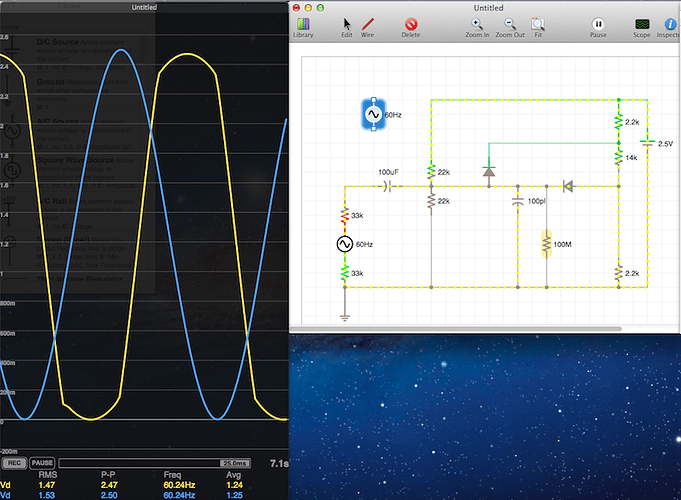

I decided to try out a couple of configurations based on your suggestions that I hope I interpreted correctly.

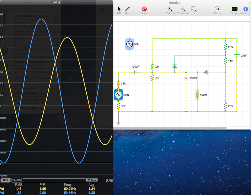

I have enclosed two screenshots that I hope are interesting / useful... It occurred to me that the protection diodes would have a hard time protecting as long as their forward voltage potential wasn't adjusted. So, I created yet another voltage divider that may be just gilding the lily for all I know. I am assuming Schottky's here, 0.222Vdrop at 1A. iCircuit is extremely limited re: inputs in the interest of simplicity. I hope that it accounts for the different forward voltage drops in diodes as a function of current but I'm not super confident it does!
The first screenshot shows conditions under nominal 115VACrms conditions. I.e. the secondary voltage amplitude of the transformer is 6.5V (4.6VACrms*1.41), offset for fun by 2VDC. The yellow line on the 'scope' shows the voltage drop across the 1M resistor that stands in for the ADC while the blue line is a idealized VAC supply with an amplitude of 1.25 and a DC offset of 1.25V.
At 115VACrms the inputs into the ADC look pretty good. The curves are nicely formed, I see no distortion. Now, lets try a 230VACrms input. Note how the diodes are getting a workout and how the tips of the ADC violtage curves are getting compressed. There are no excursions above 2.5VDC or below 0VDC (so the ADC is safe). Then there is 150V MOV... Not sure if it's strong enough to blow a 1A slow-blow fuse before it goes boom, however.
That aside, the above looks promising. But I don't trust this program enough to accept the above as gospel. Any SPICE programs out there with a good GUI as long as it's either Mac or Windows? I'd like to think that WinSPICE would allow you to adjust component behavior with a bit more granularity.
