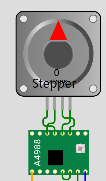

(off topic, but if you want your stepper to start at 0 rather than -2, cross the wire pairs...
Before (-2 at start)
After (0 at start)
tbh no as in new to this programming and arduino stuff and dont really know what i program or what connections it uses/needs .
got my code sofar by looking at other examples and using that knowledge and proofing/testing it in wokwi
Your simulation runs perfectly. Can you point out the issue?
