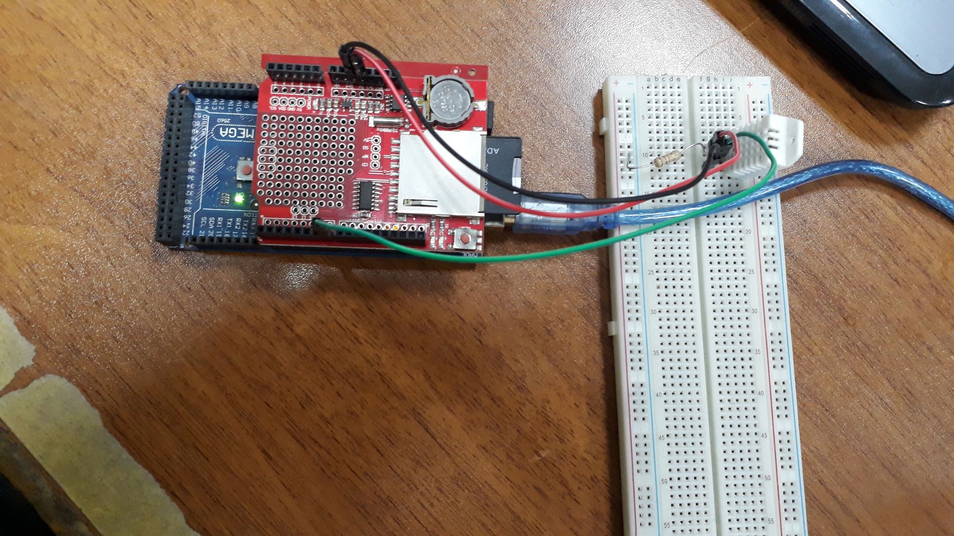

access to datalooger shield remotly
dear
i have this project to store temperature degree and humidity
i need your advice, recommendation how to improve this project so i can access remotely to the data stored in SD
i surfing net and found these tools,board
Wireless HC-12,internet ESP8266,sim 800i
any further recommendation very helpful to my
below and attached image for present project
Define "remotely".
Meanwhile, two options:
  1. Use an IoT facility, thereby enabling you to access the information while on business in Vladivostock.
  2. Dump the data via Bluetooth to your phone a few metres away.

thank you
remotely i mean through mobile,satellite,distance >=1km
Bluetooth is a non-starter, same goes for WiFi. I think the SIM800 is a 2G device, and you may find it is obsolete. I don't know anything about HC-12 but there are radion modules that should be OK at this range. I believe they are 433MHz.
