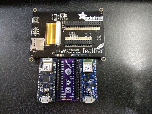

Hello everyone, I have created an adapter to use the shields for adafruit feather boards with the new arduino nano.
I am testing with this screen and with the NANO 33 IoT (SAMD21 & ESP82), it works very well, but with the NANO 33 BLE Sense (NRF52840), all the examples are drawn very slowly on the screen, I have tried to modify the Adafruit_HX8357library, without any success.
