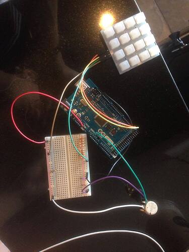

Hi guys,
I am wokring on using adafruit trellis to connect to ableton and map onto the desire function of ableton.
so far I am able to map potentiometer onto the ableton. The code works even without all those Midi library and midi begin stuff.

But i am having trouble to send adafruit trellis PCB drivers over there.
The hairless midi says "FTDI drives dont seem to be installed. not attemting any FTDI latency tricks"
I was not able to map the adafruit trellis button onto ableton. the code i have so far for trellis (sort of modified from the potentiometer code) I even used the all those midi stuffs, but the serial monitor starts to print weird chinese or japenese letters. Trellis works fine and when i press the button, it lights up

This isn't the Adafruit support forum, so I'm not exactly sure, but I think that the Trellis is just a button matrix and driver. I don't think Trellis has an FTDI on board. Are you hooking your trellis up to an Arduino board of some sort? An Uno, Leonardo or a Pro Micro? Maybe that is where the problem is? Tell us more about your setup.
Thanks,
Jimmy
Thank you for your reply, I have hooked up adafruit trellis to arduino mega and then from the usb to the computer. I was hoping to make it work with the potentiometer together. and yes, trellis is a PCB driver and they require a different library. When i use trellis library with midi, it starts to print weird letters and show that error message of FTDI driver. link to setup below.
http://postimg.org/image/s8bnwnn7v
Would installing the FTDI driver helps? Would there be anything to do with the trellis begin with midi begin? Like fighting over the same serial port?
Thanks again
It's best to just post the image here. I can't see what's going on in your picture, or how it's connected to Abelton right now. Can you draw a sketch of what your hookups are and post a picture of that sketch here? Maybe then someone will be able to help.
Jimmy
Edit: Obviously I don't know how to get the photo attached inline either, but it is attached here.
I'm not too familiar with the Mega, but I looked at the schematics here at Arduino.cc and there is no FTDI chip on the Mega. I think Hairless wants an FTDI serial interface? If you want to make a midi button and knob controller with that trellis, you might use a leonardo or a Teensy. You could then have it act like a MIDI HID device. Then you wouldn't have to mess with a lot of translation via Hairless and all that.
