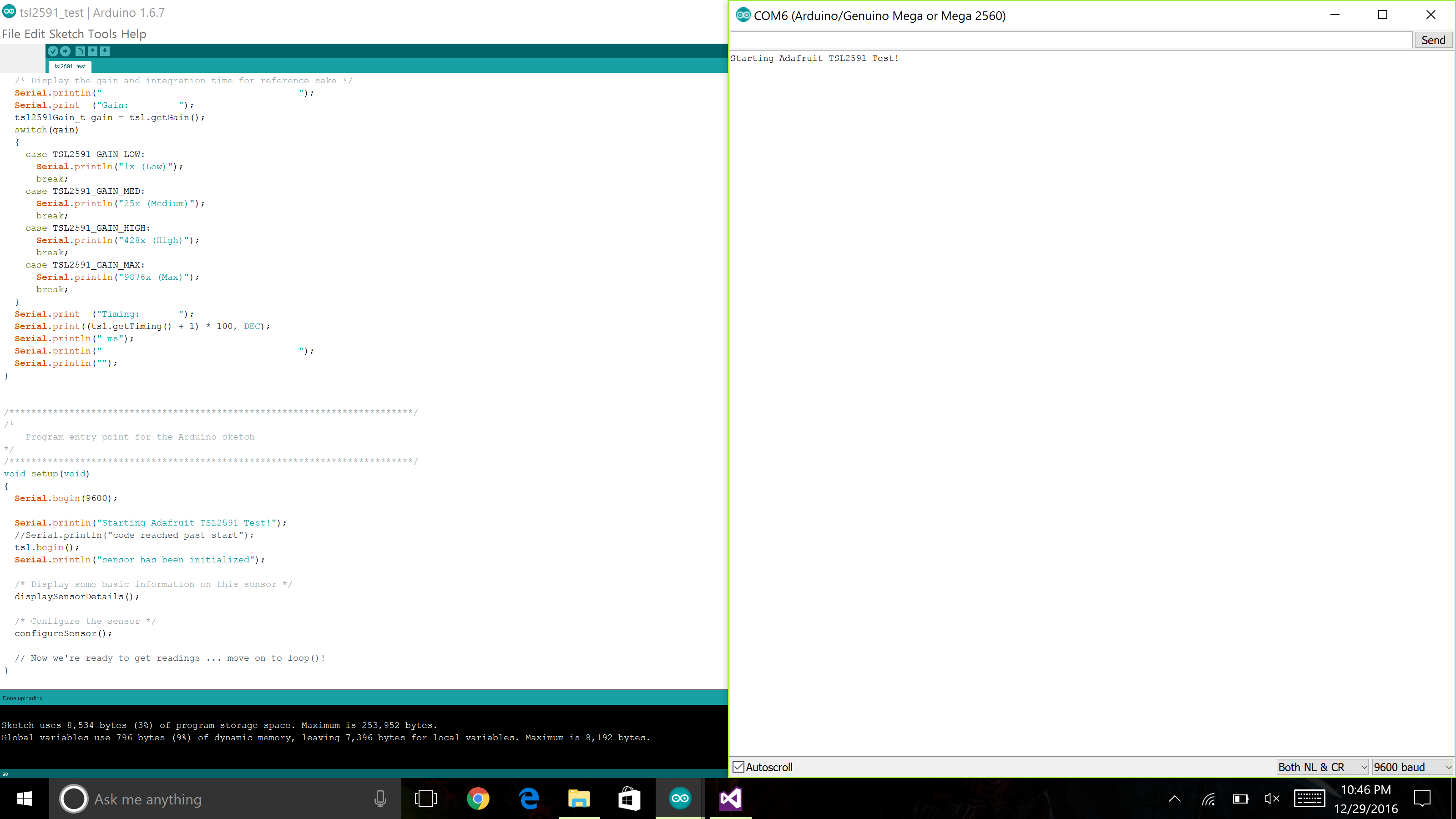

So i have a TSL2591 and when I use the example code, I don't get any output.
If you need to code you can find it here

Any help would be appreciated
Here is the link to the website if you need documentation
It appears as if the example code you are using is broken. in the 'loop' method it tries to call the method "avancedRead();". I just scanned through the code and it contains no method called advancedRead.

It does however contain the method's simpleRead() and unifiedSensorAPIRead(). I suggest calling the simpleRead() because it prints the luminosity of the human visible spectrum but it can also print the infrared, infrared and visible spectrum together if you uncomment some of the code. The code i fixed reads visible light luminosity and is below.

I hope this helps and if it did please click add next to my kama. If you need anything else just message me.
