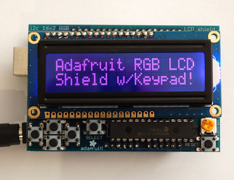

Gfvalvo may be correct. The LCD is an old design and will not run at 3.3V. it needs 5V. It's inputs may or may not respond to the 3.3V signals from the esp pins. You can try, but if it does not respond, you will need to use level shifters on all 6 pins connected to the esp.
This may mean that it is simpler to use an i2c backpack. The backpack will also run at 5V, but it's i2c inputs will respond to the 3.3V i2c signals from the esp (I have tested that with my backpacks).
