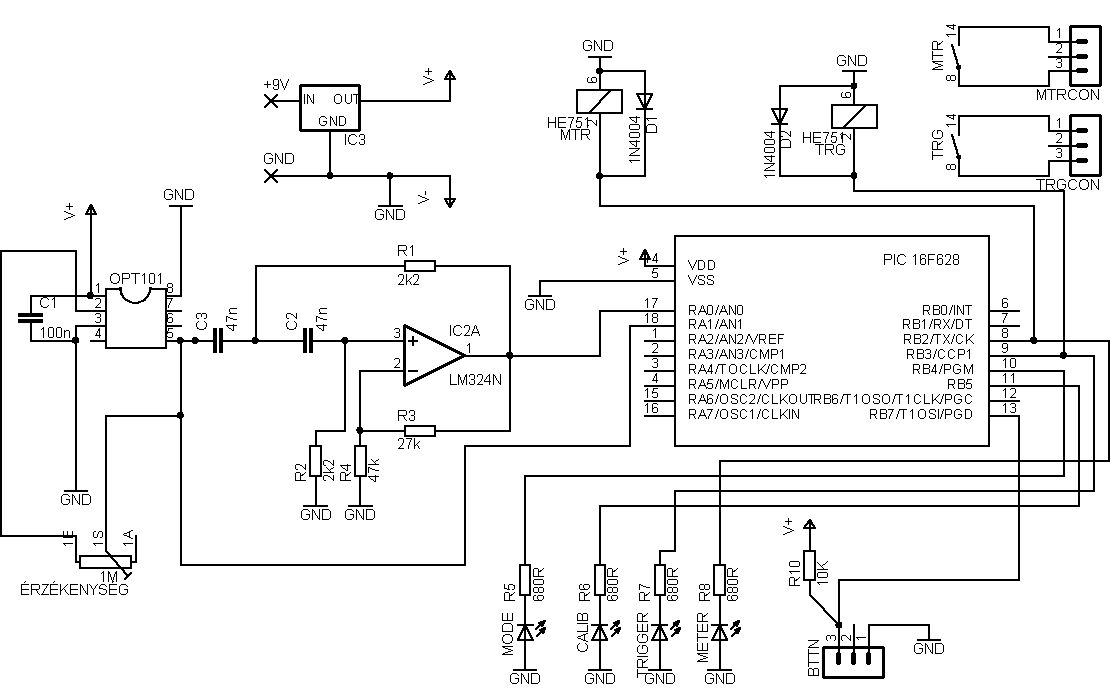

Hi guys,
I’m working on building a lightning trigger that triggers a camera whenever a light sensor sees a lightning strike. I found some code online that unfortunately is written in Assembler but I’d like to understand what its doing and basically recreate it using an Arduino. Unfortunately, Assembler is completely foreign to me. :frowning:
From what I understand the micro gets it’s input on lines 17 and also 18. Line 18 is the signal straight from the light sensor while the signal to pin 17 comes from a high pass filter that only triggers on fast light changes. When the PIC sees a ‘flash’ it triggers the camera through pin 9.
Here is the assembler code:

My questions are:
  • What is going on in the ‘calibrate’ function?
  • How does the micro detect a lightning flash? Is it using the input on line 17? Or line 18? Is it comparing 17 to 18? Something else?
If anyone could help me make any sense of the assembler code I would be very grateful! I'm also including the circuit schematic so you can get a better idea of what going on.
Have you downloaded and studied the P16F628 data sheet so you have some idea of how the device works?
Quite honestly you are better off writing your code in C on an Arduino. All machine code is specific to the processor it runs on, so it is not easy converting from one to the other because there is no one to one conversion.
By the way your schematic has the LEDs wired up the wrong way round, they will never light up like that.
I'll admit that I only looked at it. It's a 178 pages and a bit overwhelming for me.
I was mainly after understanding what it does so that I can replicate the function with an Arduino and there where I was struggling.
Good catch on the LED's! This isn't my schematic but I didn't even notice it.
Where did you find this project? If no explanation of the functions is offered, look for a better project tutorial.
AMS makes a lighting detector chip. Take a look a the Sparkfun module and tutorial.
BTW the code uses the analog comparators of the PIC processor, so it is just looking for a very rapid increase in the light level (via the high pass filter, relative to background). Easy to do on any microprocessor.

I'll take a WAG.
With the switch in the Cal mode, ou adjust that pot on the OPT101 until its output just balances a selected comparator reference of 0.625V or 1.041V. The Cal and Mode LEDs bounce back and forth until that happens. It starts off at the higher voltage and moves to the lower to fine tune.
When you move the switch to the trigger mode it enables the metering optocoupler which must put the camera in the metering mode and then when a lightning flash is detected the shutter is opened through the other optocoupler.
When lightning trips it you get an arcade like light show from the flashing LEDs.

Do you know what signal the code I posted compares? The filtered or the unfiltered? And why are there the 2 signals. And does it compare it/them to an internal reference?
You're right, that does look very similar. I read the description but I still don't really understand what exactly the code is doing...
