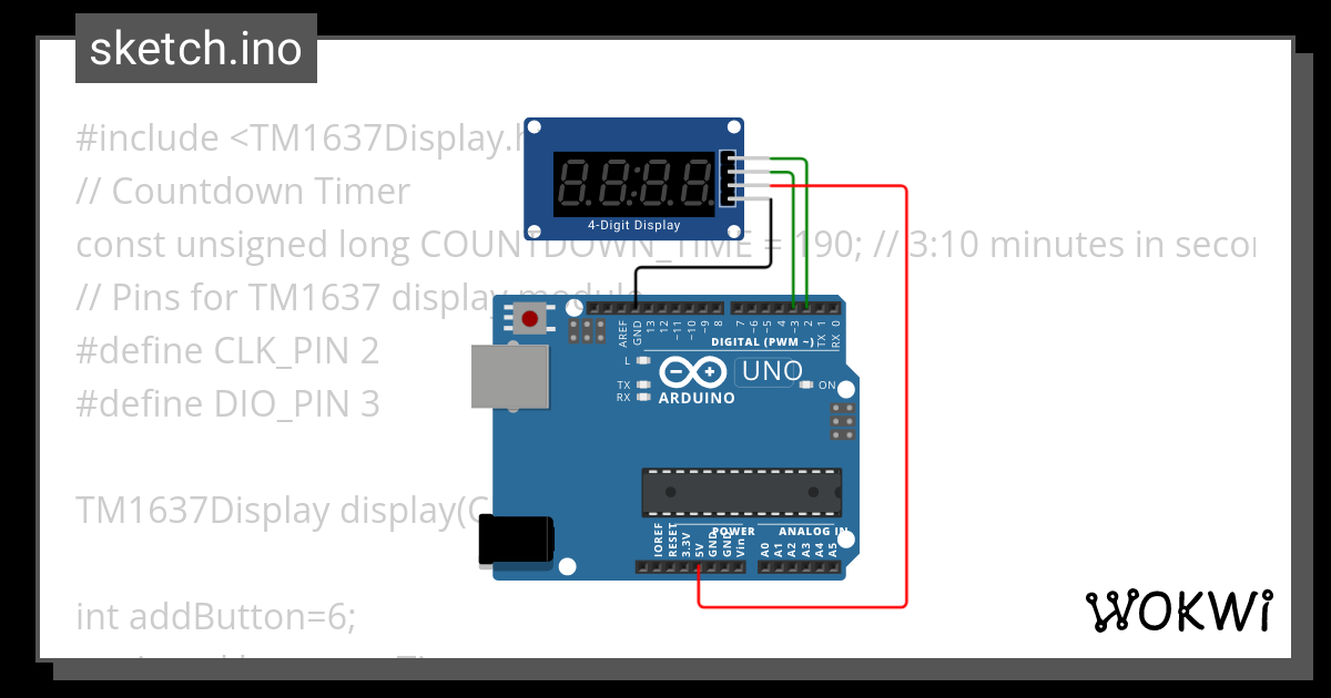

Try this code:
Thank you so much, what software is that you send me that's awsome?
I did not understand your question.
Can you please explain better?
