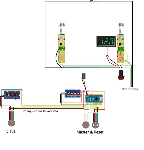

Always show us a good schematic of your proposed circuit.
Show us a good image of your ‘actual’ wiring.
Give links to components.
And
Tell us what does not work.
Hello Larry;
I didn't include a schematic as my question was strictly programming related, but here you go.
There are two independent circuits. The above circuit is the Hot-Wire circuit, running on variable A/C voltage supplied by a variac.
The lower circuit is the counter and display circuit. Each PCB and Counter set-up are housed in separate handles 25 feet apart.
So far, this all works as is. But like I said, I am looking to modify the program for an adjustable countdown action. I would in turn need to add three more momentary buttons to the MC, "increment", "decrement" and "reset". Those are not yet pictured.

25 feet is quite a distance :thinking:
A sequence of events list would be helpful for us old timers to fully understand what needs to be added :wink:
example
  • master toggles their button till they get to 10
  • slave toggles their button till they get to 10
EDIT
Explain a bit more ?
Don't you have a reset already ?
Same countdown time for each step or unique times for each step?
This sketch should be close:
EDIT
Added comments

Sorry, i could have been clearer about the sequence.
The delay on the timer would be calculated while preparing the piece, lets say 5 seconds.
I adjust for 5 seconds on the master control, i would see the adjustment in the screen, once done it would flash the display and then show our 00:00 on each of our controls. Only the master control has an adjustment, while both have counter displays and increment buttons. We start our cut, i get to checkpoint one before my partner, push my counter +1 button and i wait. They get there shortly after and press +1 on their control. The program detects that we are both at the same # checkpoint and starts a 5 second countdown. The countdown times out, flashes once then we continue to #2. Again, same countdown time, only counting down once the numbers are the same.
If no delay was needed, the countdown would be set to zero and the program should ignore and countdown timer.
There is a reset button now, but only for the counter. I would add three more buttons to my control for the timer. (+1 second, -1 second and reset).
Possible? As i said, way beyond my skills.
That’s why we need an exact time line.
Things will need to be modified then.
Try the sketch offered you in post #8.
The way it works now.
  • the Master sets the countdown value, say 5 seconds, once set, it stays at that value until it is changed again
  • both counter values are 00
  • Master gets ready to move so they push their switch his/her counter goes to 01, Slave sees Master’s 01
  • Slave pushes her/his switch, it is = 01
  • the two positions are equal so a 5 second countdown happens and times out
  • both positions are displayed again, then a user increments their counter again . . .
  • things repeat
What would you change exactly ?
Thank you so much Larry! I’ll try it tonight and let you know.
You make a statement “we start our cut”.
It’s not clear how the Master tells the Slave to start moving/cutting.
You must explain exactly what needs to happen and when.
Don’t just say we start our cut.
Remember, a computer needs the exact sequence of events.
A point to point sequence needs to be documented.
Example
Step
  1. counters are 00:00
  2. Master sets the countdown time to 5 seconds.
  3. After 2 seconds, 00:00 is displayed, both start cutting/moving
  4. Slave reaches 01 and increments their counter to 01
  5. Master reaches 01 and increments their counter to 01
  6. The 2 counters are equal so the countdown starts and reaches zero.
  7. donE is displayed on both displays
  8. both start cutting again
  9. Master reaches 02, increments their counter
  10. Slave reaches 02, increments their counter, countdown starts again.
  11. donE gets displayed
You need to do something like shown above.
EDIT
Also, as the sketch in #8 is written now, my above sequence should suffice, however, how do you tell the other person to initially start cutting ?
Hello again.
Yeah, that cue is usually a verbal or visual cue. As I said originally, these hot-wire cutters are normally pretty simple affairs. Usually just a plug into a variac and the cable separated with the positive running to one handle and the negative to the other, with a Nichrome wire in between as a filament that cuts. The hot-wire cutters I have been making are more just personal projects to make them safer to use and enhance the communication between two operators a distance apart in loud environments. There will still however be a minimum of verbal and visual cues.
I wish I had a video or photo to show you the process in action. Sadly a combination of me having my hands full at the time and signed non-disclosure agreements makes thins impossible.
I am going to connect my prototype shortly and try out your code. I really appreciate your help here. I could never have come up with this on my own.
So Larry, great news!
I put it together on the breadboard and flashed the code, everything does exactly what i needed it to do!!! You are amazing! I definitely owe you a beer or two!
Sadly my “breadboard friendly” buttons don’t seem to make contact with the strips in the breadboard, so i couldn’t film the setting of that, but it does exactly what it should. Thank you so much!
Send me some contact info and i’ll figure out how to get you those cold ones!
P.s.: another sad thing about the video i shot you is that the forum won’t accept video. Doh!
Here we go, I found a small compromise. I managed to fumble and take some progress photos.
The first is the set-up on the breadboard.
The second, the master has been incremented from 1 to 2 and I am preparing to increment the slave by one... 0 to 1 happened so fast I couldn't get a good photo.
Next, slave +1 then the beginning of the countdown...
That's awesome! Thank you so much!

In your spare time ;) , make a more permanent solderless breadboard setup.
I've been messing with the code a bit on my end too, just playing around to see how things work. I really appreciate your help here, and with your modified code commenting, I will be able to study it and learn a little more.
Thank you so much!
Yeah, a more permanent breadboard set-up would be good. I have about 60 other things I gotta finish first though. So many things on the go.
