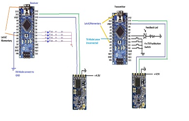

I have want to install the millis command in this program from youtube for button number one - the program is set up so when the first button is pressed the led comes on then to turn off I press the first button again - I want to only press the first button once then keep the led on only for 3 point 6 seconds -
This uses two arduino uno and two HC12 and it operates ok on this original program - Both arduinos use the same code for TX and rx - the only difference is that A4 is grounded on the rx arduino
here is the code

  • D2 --> SW --> GND (SW1) A4 --> GND
  • D3 --> SW --> GND (SW2) D2 --> OUTPUT 1
  • D4 --> SW --> GND (SW3) D3 --> OUTPUT 2
  • D5 --> SW --> GND (SW4) D4 --> OUTPUT 3
  •                                       D5 --> OUTPUT 4
  • FEEDBACK back will light Led on Trnasmitter for 100mS
  • See connection Diagram here:
  • https://goo.gl/photos/qog8gWPKpSDPgZen7

I would only need D2 to be set up with millis for 3.6 seconds for the present times and I would thing that the millis would only needed to be setup on the tx side - but I am not sure on how to add it into this program
In the future I would like to be able to use button number one and two (D2 and D3 to be able to be pressed for a different time seperately
Here is the url which may help
Thanks in advance

Maybe something like:
Replace this statement “read_P1 = digitalRead(P1);” in function void TX_MODE() with code which :
A) detects the button transitioning from “not pressed” to “pressed”.
B) sets a timer on the above status change. (Record current value of millis() )
C) also sets read_P1 to 1 on the status change.
D) checks if read_P1 has the value 1 and checks if the timer has expired (3.6 seconds). If so, read_P1 is set back to 0.
