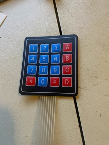

Im sure this will be very confusing but hopefully someone can help. I am trying to make a string which value is values entered into a keypad I do not know which keypad it is, I got it from elegoo
I have Programed it to Put numbers on a LCD But I need to Create a 1 string variable and 3 int variable based on the characters entered. My lcd is set up like this,
The code I tried to create this string only gives me 1 Character at a time in the serial monitor. I have made a string called theChar which changed when somethings printed on the LCD to what is being printed, and my code thats a problem is this,

These variables are local to loop() so each time through loop() they get created fresh. Since you set them one at a time, only one will ever be set when you print the string here:
To fix that problem, move the declarations of the strings to above loop() to make them global or add the 'static' keyword to the beginning of each declaration to allow them to keep their value when loop() re-starts.
