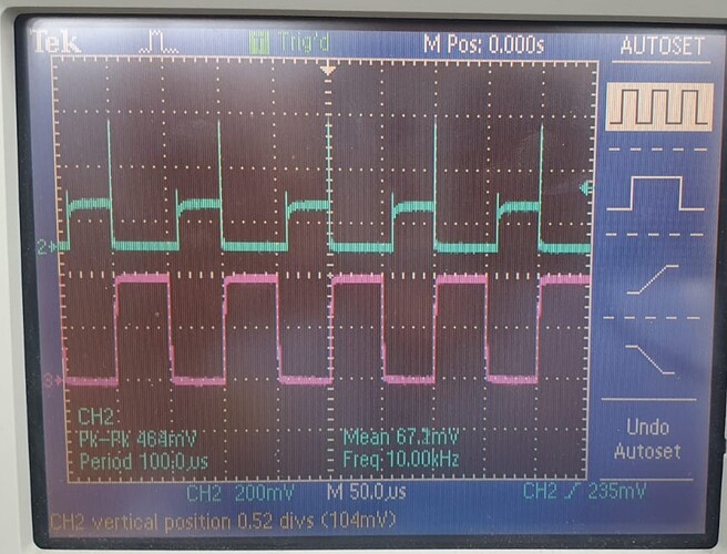

Diettrich,
Switched M2 from FQP30N06L to 2N7000,
It look much better,
Attached is a picture of R2 voltage drop in blue,
and M2 Drain in pink
We lost the delay, and also voltage spikes on R2 looks better.
V/dv of blue channel is 200mV/dv,
pink is 2V/dv.
Both DC Coupling
I guess that from some reason (gate charge?) M2 took long to turn on and it had problem to the feedback loop so we got voltage oscillations.
We still have a smaller voltage spike on the output when the mosfet switching.
Thank you
Added falling and rising 'zoom in' images, same parameters except from horizontal scaling ofcourse
It looks like the voltage spike at the output (R2 Blue channel)caused by the slow drain rising? at the falling edge since its fast, the feedback loop behaves good without spikes.
It could be that switching to smaller MOSFET helped to reduce raising falling timing but still rising is quite slow maybe due to the opamp and BJT, and replacing them with faster components will help
Could be??
