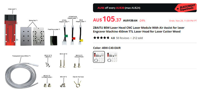

Hello all,
I'm trying to use a PWM signal from arduino to drive a laser module with only 3 pins: +12V, GND, TTL/PWM
I read this topic , but still not sure P or N channel mosfet should I use.
Can someone advise me?
Thank you in advance.
Best Regard
Denis

Hello @TomGeorge ,
The laser is from THIS LINK
I can use Arduino Uno, but my question is basically how to do it.
I got one small N-channel MOSFET module but I'm not sure is it suitable or not.
Hi, @DBSDBS
Your laser;
Your MOSFET.
They do not say if the MOSFET is logic level control or not, which will be essential for control logic from a microcontroller.

The answer is in the specs in the image of #4.
PWM input: 3.3-12V
Your Arduino outputs 3.3V or 5V depending on the model, so that signal should be able to control your laser directly. Just remember to connect the grounds as well.
Do remember to be very careful with your laser. Never look into laser with remaining eye!
