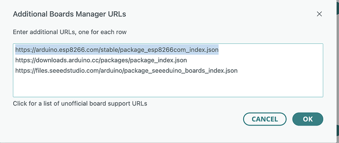

Is there anyway to download http://arduino.esp8266.com/stable/package_esp8266com_index.json, and not have it go to the url everytime the IDE starts ?
Just check if there is any update, the package was already downloaded the first time.
Just copy this LINK and paste it into the additional boards box.
Maybe you are doing something different. Open your settings/preferences and click where circled in RED
Now paste that URL in this

I already have the json file, and have it update in Preferences.
It seems like the IDE goes to that link everytime, and it takes some time to check.
I just wanted to eliminate the check.
and download whatever the latest info it is getting, and not have it check.
I would think i would get another notification, if i ran into a problem, then i could go check for updates.
I am using IDE 2.1.1 on a Windows machine.

Those two goals are somewhat contradictory. The only way for Arduino IDE to obtain the "latest info" is by downloading the latest version of the package index file.
That said, I'll provide instructions you can follow to disable Arduino IDE's automatic updates check which causes the periodic download of the package index file:
  1. Press the Ctrl+Shift+P keyboard shortcut (Command+Shift+P for macOS users) to open the "Command Palette".
    A menu will appear on the editor toolbar:
  2. Select the "Preferences: Open Settings (UI)" command from the menu.
    You can scroll down through the list of commands to find it or type the name in the field.
    A "Settings" tab will open in the Arduino IDE main panel.
  3. Type arduino.checkForUpdates in the "Search Settings" field of the "Settings" tab.
  4. Uncheck the box under the "Arduino: Check For Updates" setting.
  5. Close the Preferences tab by clicking its X icon.
If you disable the automatic update check, make sure to periodically do a manual check for newer versions of Arduino IDE and your installed boards platforms and libraries.
