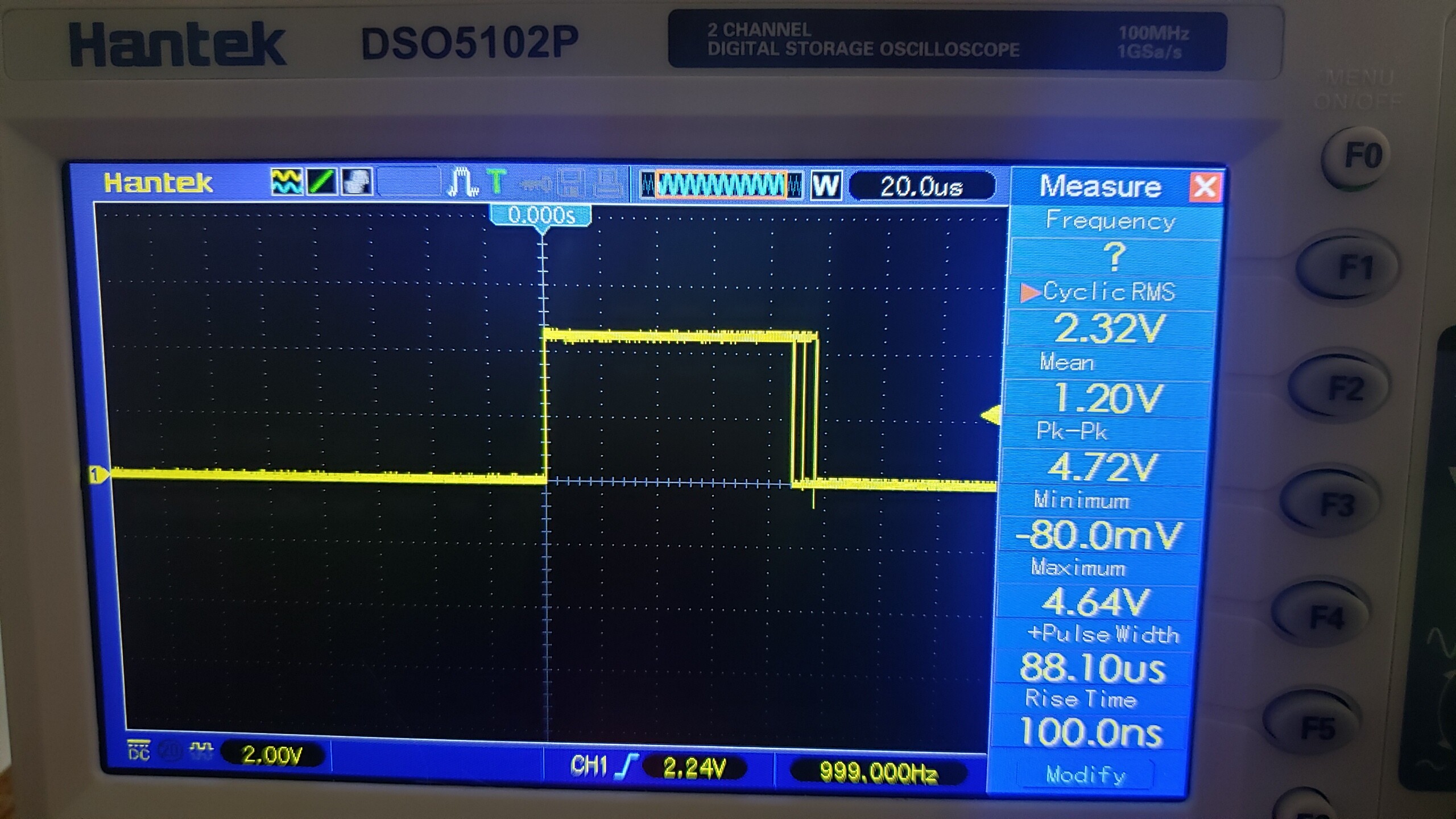

additional falling edge when using timer
I do not use a timer, its a steady square wave, I use a timer I see a additional falling edge all throughout the duty cycle flashing on and off of the oscilloscope. The atmega328p is supplied with Vin and using KU5021S28-HL-ND potentiometer military and commercial suitable. My LED flickers way to much. I have small code and picture.

analogRead returns a value between 0 and 1023. You then multiply that by 249, then divide the result by 1023. Arduino have 16-bit integers. What is, say, 1023 * 249? What happens when you jam that into a 16-bit int?
And, you are jamming it into the compare register totally asynchronously. What happens if the counter has already counted PAST the new value?

It should be 1024, not 1023. Was the first post edited? I see a 249L not 249. Later in the code I see the problems mentioned in reply #1. You started out okay, though...
Interestingly, you did a serial debug print of 'z' for example. What values were printed?

Also, when I serial print 'z' it will plus or minus 1 rapidly.
I would just map the pot reading to the OCR2B range.

If there are issues with the synchronization of the compare match duty cycle changes, that can be addressed by making the changes in an overflow interrupt.
