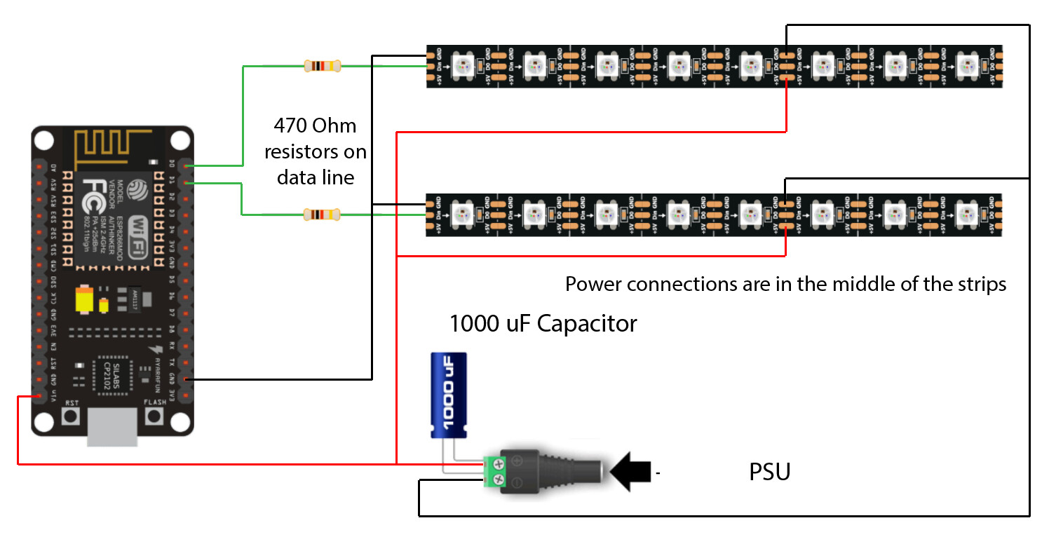

All 9 strips run data line from the board through a 301ohm resister and receive power from 2 5v 40A power supplies. Both power supplies and the board are ground together.

It is recommended to "inject" power every meter.
  • Measure the 5v supply on this strip, confirm your GND is properly connected.
  • On the bad strip, assume non of the pixels work properly.
    You could try cutting off the first pixel and insert the signal on the second.

  • inadequate voltage on that strip 'confusing' the LEDs (measure the voltage at the far end of the strip, compare to other strips that function)
  • software malfeasance
    Testing
  • of course, measure voltage at far ends of all strips
  • swap two strings on two Arduino pins - does the problem move, or remain on the same strip
