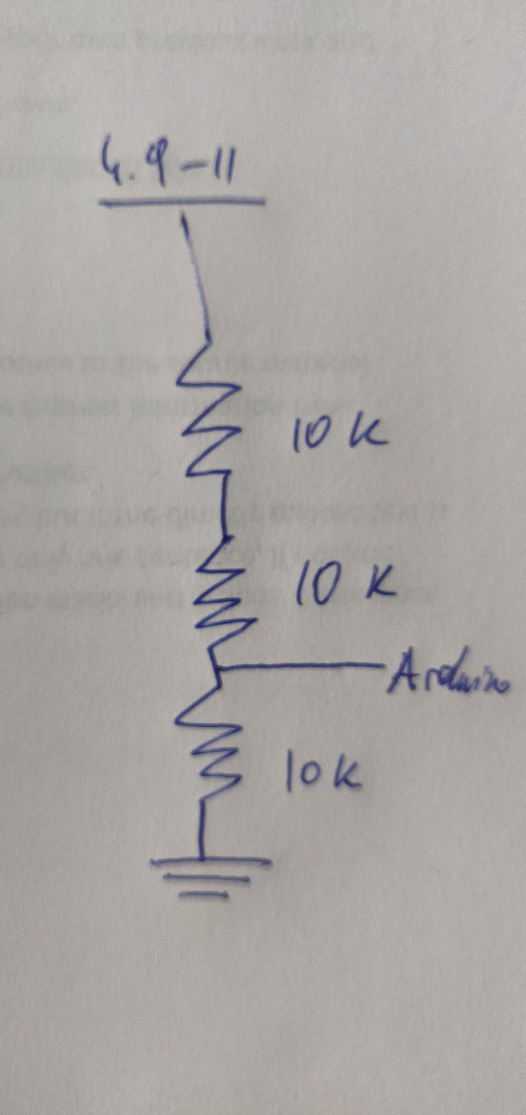

I gotta be honest, though. I don't have that many types of resistor. So I made a voltage divider from one 20k and one 10k resistor. That will leave me with 4 Volt, rather than 4.97.
But going by your numbers that should still be plenty enough, right?
My 3 voltage values are 10.8, 8.5, and 6.5.
Or should I get new resistors?
Nooo... Too high! Put 2 10k in parallel for R2 that will make it 5k, then 5k / 25k = 0.2 * 24V = 4.8V, ADC val 983. To be safe, put a 10k in series between analog pin and voltage divider junction.

The highest I'll get to is 11 V.
My current setup is in the image I attached.
That would put me at 3.67 V. Which isn't great. But I only have these resistors: 10, 100, 220, 330, 1 K, 2 K, 5K, 10 K, 100 K, 1 M.
I'll add the resistor before the analog pin to be sure, though.
EDIT: What if I put 5 K and 10 K in series, then divide to the analog pin and then a 10 K again? That would leave me with a maximum of 4.4 V, right?
OPs images.
Tom... :slight_smile:
That should work, just keep input voltage below 12.5.

Now there is another wrinkle to this that's annoying: the entire intercom system is AC. In other words I had to use a DC rectifier and then get the voltage down to prevent blowing up my Wemos board, which - when the voltage changes - sends me one of two telegram messages via home assistant.
BUT there is a problem: my calculations were apparently off, because instead of having 4.4 V I get exactly 2 V when the bell isn't ringing, and when someone rings the building's doorbell the voltage actually goes UP to 4.3 and increases even further to 4.75 when the apartment doorbell is rung.
First of all, what have I done? Why? And also, that's not all:
The weirdest thing is that I can read this voltage when I put the multimeter clamps on the anode and between the last two resistors of the voltage divider; however, measuring voltage between the point between the last two resistors with ground (both from the arduino and a cable) the voltage is freaking ZERO?
What gives? Can anyone explain what's happening? Did I not get the ground right?
Thanks in advance^^
After you have rectified the AC, have you got a smoothing capacitor to get proper DC?
It sounds by those DMM readings you are looking at rectified AC, but no filtering/smoothing.
Can you please do a circuit diagram including the AC feed and the controller, you may have grounding problems because of the AC doorbell switch circuitry.

In other words, what you are saying, what I have here is not in fact DC but rectified AC?
I thought rectified AC is DC...
To give some more context to the horribly drawn diagram: the five circles at the top correspond to the five pins in the intercom with their corresponding cables coming out of the wall (not drawn here here).
The voltage between pins 3 and 5 changes when the doorbell is rung.
As a side node, the circuit for the door buzzer downstairs is between pins 4 and 5.
EDIT: also, isn't a rectifier already a glorified capacitor? If I put a capacitor after that, won't that massively delay the voltage change?

Rectified AC is just voltage pulses, all in the same direction, not a continuous voltage.
The choice of capacitor will govern the ON / OFF apparent delay when switched.

Rectified voltage goes up by 1.414 time AC.
Use the full bridge rectifier with a capacator.
Measure the new voltages for each state
Calculate the new voltage divider
Bob's your uncle

You can use the numbers you get.not recommended.
AC will not be steady so you can do some smoothing in software.
The proper way is to use a cap. Since you are using large resistors the cap does need to be large but MUST be rated for double the voltage of the highest in the system.
