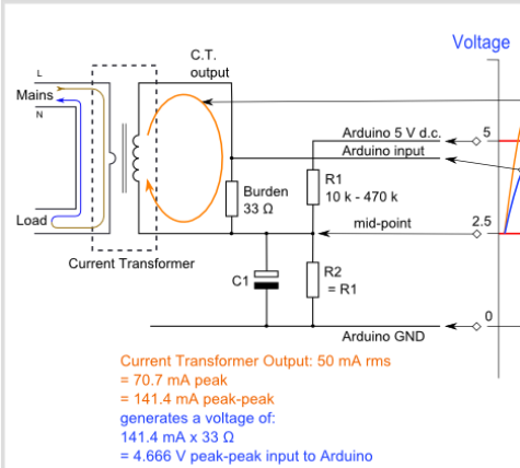

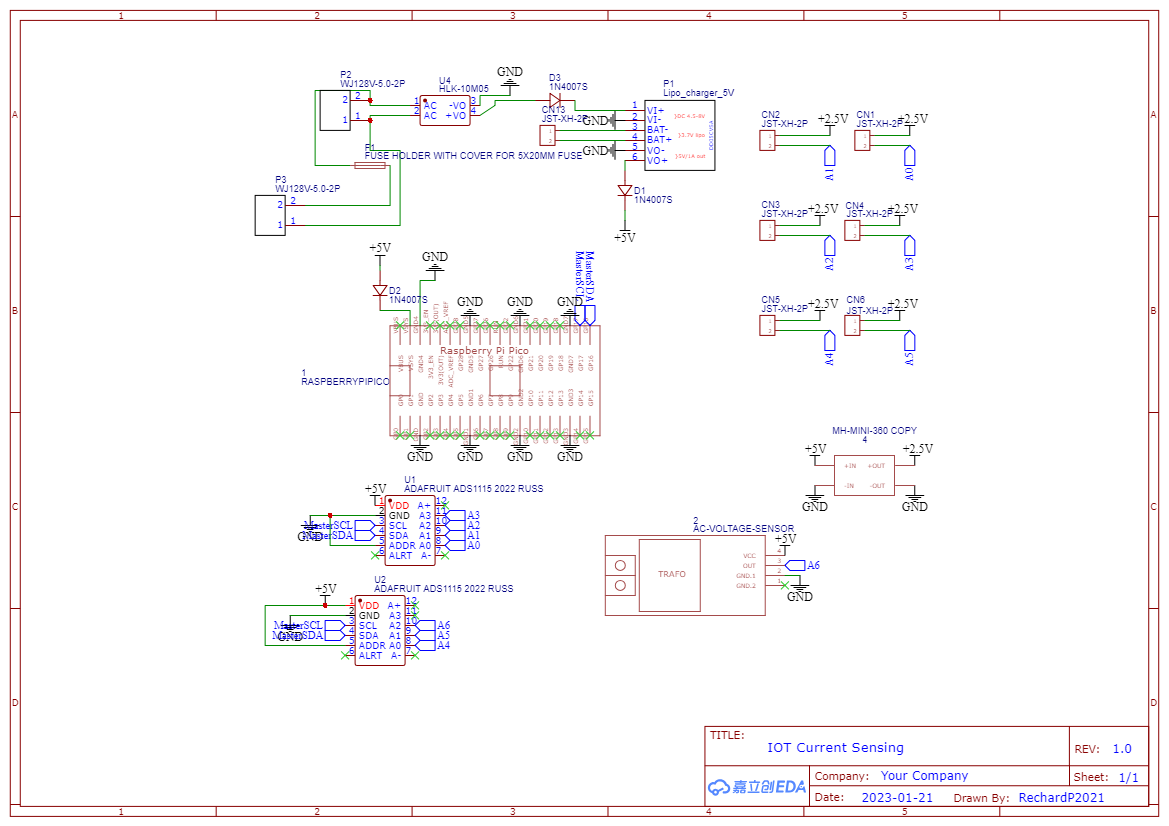

I picked up a sct013 100A current clamp and a ads1115 for a homebrew powermonitor system using a pico/arduino.
I followed the write up by https://solarduino.com/diy-ac-energy-meter/ and this forum thread: https://forum.arduino.cc/t/solved-how-ac-current-can-connect-to-ads1115/953906 but the reading I'm getting out seem to be wrong or wrong accoring to my current meter.
I am using 2.5V to power the sct013 so in theory my lowest reading should be 0V and my highest 5V. Firstly is this wrong and secondly if someone could just go through my code and point out where my calculation is whack that would be great :sweat_smile:

Please post a wiring diagram of the input circuitry.
This tutorial is a very useful resource, with clever Arduino code. Your CT should work fine with the suggested circuit and software.
I have no idea how people make those arduino sketches but I do have my pcb schematic. :sweat_smile:
Pencil and paper works fine to produce a wiring diagram. Otherwise, just follow the OpenEnergyMonitor schematic.
It aint pretty
Sorry, I can't make any sense of that. Unnamed parts, unidentified pins.
This is a sensible wiring diagram of the CT input circuitry, from the OpenEnergyMonitor site, and is an excellent example to follow.
Capture
Yeah this is pretty much what I'm doing, my current transform only has two wire so I have an external dc-dc circuit that gives me the 2.5v for the power wire.
Bad idea. The dc-dc circuit injects electrical noise.
A much better and cheaper idea is the standard approach of two resistors and a capacitor, as done in the OpenEnergyMonitor example.
