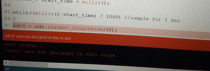

thank you @JohnLincoln but still error :frowning:

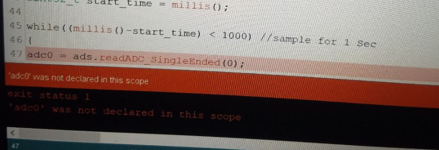

but when i run i got this error
Please do not post error messages using photos or screen captures. Copy the full error message from the error window and paste it into your post between code tags. There is a small button at the top-right of the error window to copy all the text.
The error is because this line
int16_t adc0;
is in a different function to the one that uses it.
