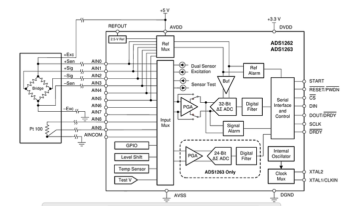

Hi... I am trying to measure voltage difference using ads1263 with arduino mega/Teensy 4.1. When i measure only one differential input pair of ads1263 (A0-A1), the sampling rate is very fast but as i use more than one pair of ads1263 (like A0-A1, A2-A3 etc.) i am getting only 3-4 sampling rate... In the code, if i reduce conversion time less than delay(55) it gives only 0 voltage for all channel ... i have tried with drdy pins as well but having same issue ... anyone please help ... Thanking you in advance... Here is the code .. I want more than 500 sps per channel ...

Are you aware that the ads1263 is only one ADC that is multiplexed to each of the 10 inputs.
If you are only using A0 and A1, you only have the two conversion times.
If you add A2 and A3, that is 4 conversion times.
The conversion time does not change, the acquisition time does.
The more inputs you want to read, the longer it takes to read them all.

There will be a tradeoff between gain, noise and speed.
You will need to use the DRDY line.
Try setting the sampling rate to 7200SPS and the filter to sinc4
Set ADC Conversion Run Mode to pulse
The filter is selected in register MODE1 (address 0x04)
select sinc4
