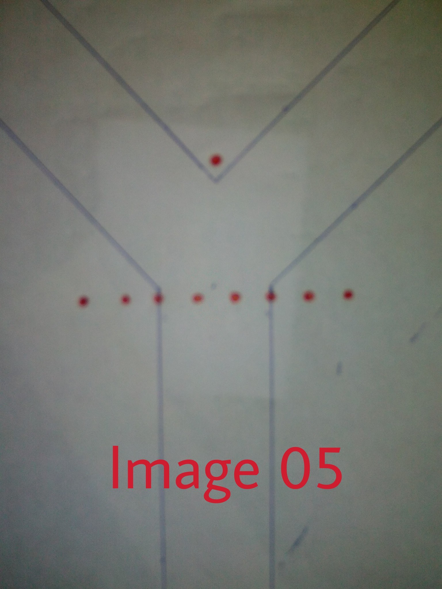

3)I have no idea about what to do at the Y junction. I think I should use another sensor in the middle a head of the others. Will it work?
Any comments?(image 5)

I'm not sure about the number of sensors to use. More sensors may be hard to code properly.
On an (almost) straight line a couple of sensors should be on the track, some to the left/right be off track. Eventual false readings (00110100) can make it hard to distinguish the on-track sensors from off-track or other situations. A center-ahead sensor may be helpful for detecting 90° turns or Y.
My problems with such a robot were:
  • could not be steered fast enough (scripted, not Arduino code)
  • could not move slowly for debugging (DC motors with encoders, here stepper motors should work better)
  • single caster wheel didn't prevent tilting with fast braking (two caster balls should work better)
  • the robot moved or turned the paper plane (course) on my carpet, when braking/accelerating/rotating too fast
I couldn't fix all these issues and gave up after some experiments, my (universal) robot kit was not well designed for that purpose. You should be able to avoid these problems with your own design. I've seen a video with cars following a round (oval) course at about 30km/h, so it's feasible in general :slight_smile:
From my experience I'd use stepper motors, which can be controlled precisely (speed and distance), not DC motors. Once your sketch works fine at low (snail) speed, you can start tuning it for higher speed. Eventually I'd try analog sensors, covering a larger (sideways) area, instead of multiple digital spotting sensors. This could give a better value (difference) for a PID controller on (almost) straight lines. Eventually two such pairs near the casters, not at center - not sure whether this is a good idea. The code can use additional sensors in case of sharp bends or Y. An ahead sensor can be used to slow down the robot, in preparation of a sharp curve or tendency of losing the track. The Y IMO should be handled very specially, not mixed up with a single line following. Same for the end of the track, and 90° bends, where the sensors may deliver values that never can occur in other situations (all off while turning...). The start situation occurs only once, can be handled separately and once only. Is the robot started in direction of the course, or must it find the outgoing line?
