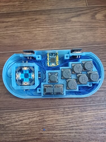

Thought I would provide a final update. I finally realized my project thanks to a way better 3dprinter than I had before and switching over to an rp2040 and using the open source firmware gp2040ce. Here are some pictures
