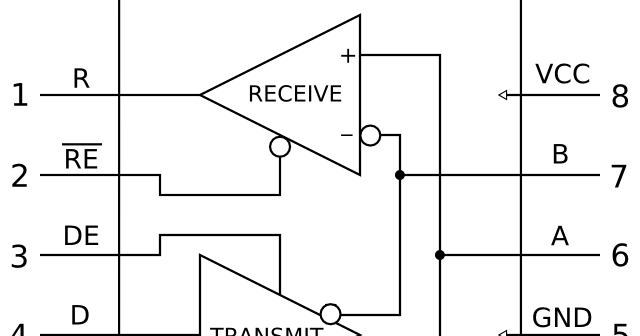

This seems like just the thing for my problem. However, the chip mentioned in that post seems to be either transmit or receive. I was wondering if anyone knows of a differential signalling IC I could have on each Arduino, so I can have serial RX/TX encoded and decoded at both ends of the Cat5.

The SN75176A can do transmit and receive but only one or the other at any given time (i.e. half-duplex.) Do you need to be transmitting and receiving at the same time?
If you’re doing full duplex, the old standby was the SN75179 but that’s an old design chip. Still available, cheap and okay but there are newer designs with higher and better ESD protection.
Use DigiKey’s parametric search for “interface, transceiver” then select RS422 and 423 types with at least 1/1 receiver/transmitter and take your pick.
To make it clear: use only matching line transmitters and receivers.
