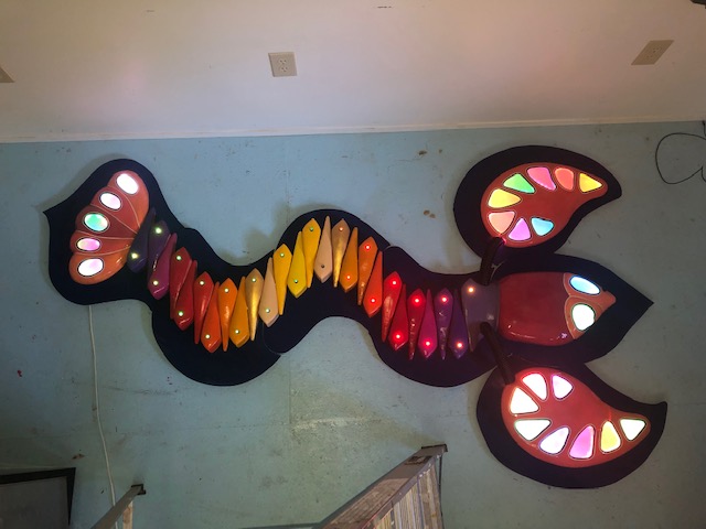

I'm building an air harp - a musical instrument with individual notes triggered by waving a hand (or finger) over proximity sensors. I have a prototype working with 6 VL53L0x sensors connected to a Wemos D1 mini through a TCA9548A mux, using Adafruit VL53L0x library, with sound generation from an Adafruit music maker shield. It's working fairly well, but ... the lag time between triggering a sensor and note generation is quite noticeable. I've timed the calls to "rangingTest()" - 25-30 msec is used for each sensor. This is too much for a real-time instrument, particularly since I want to expand to 12 or more sensors. I've researched the sensor, and this is a typical response time; apparently it's possible to get it down to about 20 msecs, but that's still too slow for my application. Can anyone suggest alternatives? I'm open to any type of sensor that will give speedy on/off responses, with sensors placed about 3 inches apart. Thanks for any advice!

Please note, I did post my code as requested, and I'll be happy to get comments on it. But every bit as happy to get suggestions for alternative devices WITHOUT digging into what I'm currently doing!!
Describe what sort of sensor you are thinking about, and what type of response you need.
If a "make or break" response will do, then an LED (or laser diode)/photodiode light gate can provide a digital output in nanoseconds. Sharp digital distance sensors respond in < 3 msec.
If you want a distance measurement or gesture recognition, that will be a lot slower, and a significant amount of time will be spent simply communicating with the sensor.

Try this in setup():
  // Start I2C communication with the Multiplexer
  Wire.begin();
  Wire.setClock(400000);
If that clock speed makes a hopeful improvement, that means the i²c bus must be contributing to the latency problem. I seem to remember there is more that could be done to reduce this, because you are currently using an i²c multiplexer, and obviously this adds to the latency. I if I remember right, it is possible, but tricky, to connect multiple VL53L0x sensors without using a multiplexer. Also, are you using continuous ranging mode and high speed mode?
Maybe some useful ideas in this topic from the Pololu forum:
https://forum.pololu.com/t/high-speed-with-vl53l0x/16585/6
Thanks very much for all the useful information, guys! I love the LED harp, Mike, especially the cool indicator LEDs! And the suggestion of using an IR or Laser emitter/detector pair is something I will be thinking about for the future.
PaulRB, the pointer to the Pololu forum post was a lifesaver! I replaced the Adafruit VL53L0x library with the Pololu one, and used the "startContinuous()" function as suggested in the post. I'm now getting a total time of 20-30 msecs for all six sensors, which is giving my harp a nice, responsive feel. I had previously tried with and without the mux, and it turns out the delay there is negligible, which allows me to keep the number of digital pins required down to the small number available on the NodeMCU. I think I'm getting close!
I did run into one other potential "gotcha" as I was continuing to research. I stumbled on an article that talks about problems with running i2c over cables: Taking The Leap Off Board: An Introduction To I2C Over Long Wires | Hackaday which has me a bit nervous. I thought I'd ask for advice on this before I start cutting and soldering to extend my 6-sensor 8-inch long prototype to the 12-sensor 5-foot long real thing. Here's a picture of the (soon to be wall-mounted) ceramic sculpture which will house the harp:
Wavster
It's a total of 7 1/2 feet long. The harp will be contained in the central portion, with one sensor centered between each pair of diamond-shaped modules. The user will wave their hand approximately 4-8 inches above the body to trigger notes. My original plan was to house the NodeMCU and muxes (I'll need 2 of them) in the head, requiring a cable run of a bit over 5 feet. I can probably fit these into the middle segments of the body, cutting the distance in half. Is this going to get me in trouble? If so, I can try the things mentioned in the article, but thought I'd ask for some "best practices" advice from the experts here! Thanks very much!
Probably not. But officially you should keep I2C down to about two feet.
