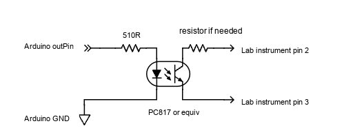

I am looking to use an Arduino to automatically trigger a piece of lab equipment.
The equipment has a 3 pin connector on the back to allow external devices to trigger it.
The datasheet provides the following information regarding the connection:
I have tested the port by using a jumper wire to bridge the trigger pin to the ground pin and it successfully triggered the piece of equipment.
Now I am looking to automate this using an Arduino to trigger the device and I am wondering what is the best approach.
Would a relay be the best bet to bridge the two pins of the connector? or would it a mosfet be a better option?
Are there any other ways to approach this? and would the use of a relay or mosfet have any limitations?

Connect a multimeter, set to measure current, between pins 2 & 3, to trigger the equipment. How much current does the multimeter read?
Hopefully it's a tiny current, no more than a few mA.
That being the case, you may not need anything other than the Arduino output pin. For that, you must connect pin 3 to the Arduino ground.
If you would rather have more protection or isolate the Arduino ground from the equipment ground, then, yes, a relay or an opto-isolator.
The next step is to use your multimeter to measure the current between the 24V trigger pin and GND. Also measure the open circuit voltage between that pin and GND. It may be about 24V, in which case you cannot directly connect the pin to an Arduino output.
You will need that information to choose the best switching device, although a transistor will probably work well.

My guess would be, since it is purpose built for an external trigger, an opto-coupler output between pins 2 and 3.

Which Arduino? 5 volt or 3.3 volt?
It would be an Arduino Giga so 3.3 volts
As @6v6gt said, use a 470 or 510 Ohm resistor between Arduino output pin and opto coupler input.
opto
