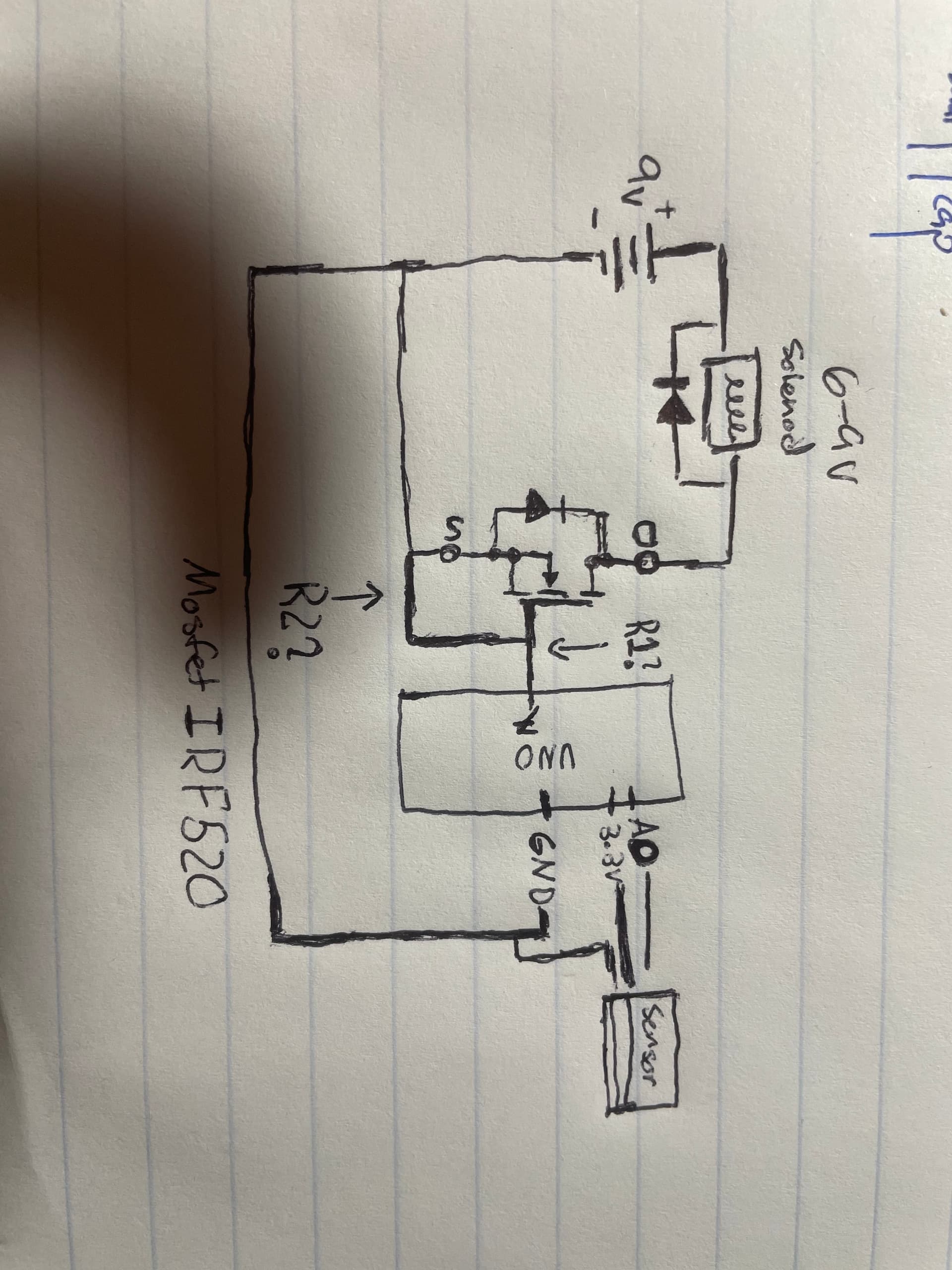

Hello,
I have been working on a project where my Arduino will act as power to a switch in the form of a MOSFET but I have had trouble in actually getting the circuit to work correctly. Whenever my Arduino sends a signal it seems that no change occurs. The solenoid requires 0.5 amps of current and 6-9v which I know my voltage source can provide. Below I will include my circuit design of the circuit I thought would work and would appreciate advice on what I may have done wrong or what misconceptions I have had. I am fairly new so I understand I likely have made many mistakes so I am open to any advice or suggestions possible.
IRF520 is not a logic level mosfet ( if you check the datasheet the minimum Vgs voltage considered is 4.5V ) so use a logic level mosfet ( or a transistor ).

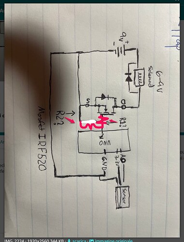

  • remove the 'short' to gnd
  • add a R1 resistor to the gate, and a R2 resistor to gnd
Can You present the "9 volt source" a bit closer?
Thank you for the advice. I will look into getting a logic level mosfet and will add the R1 and R2 as shown. When you mentioned the 'short' your were referring to where the R2 resistor goes correct.
If I might ask, what do you mean when you say present if I might ask. Do you mean drawing it closer?
Yes ( the line I covered in white )
Here is a circuit that should work for you. It will keep thesolonoid off until your code enables it. If you use an appropriately avalanche rated MOSFET the diode D1 is not needed.

Use the circuit gilschultz was kind enough to post in Post #7. Yes, you want a logic level MOSFET and low side switching. There are plenty of logic level N channel MOSFETS available. I would run a FQP30N06L but there are plenty of others which will also work.
