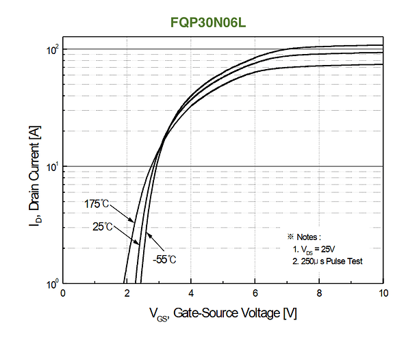

I see. Indeed - when looking at a logic mosfet such as the FQP30N06L it also specify Vgs = 5V
At which graphs should I look?
So when 0V is applied the MOSFET is ON and when a voltage above the Vgs is applied the MOSFET is off? so Why to pull the MOSFET gate to ground? like that it will be alway ON when no signal is apply at the Gate?
No. When 0V is applied the MOSFET is off, of course. Look at it from 10V gate voltage where the MOSFET is fully on. As the voltage falls the MOSFET starts to turn off. As the gate voltage decreases, the resistance across the MOSFET increases until at the gate threshold voltage the resistance is so high that the MOSFET is considered off.
We pull the gate low because without the 10K to ground the gate is floating. Like the Arduino input, a floating gate will respond to stray electric fields and its state will be indeterminate. The pulldown puts the gate in a known state.
Look at the graph in figure 3 in the data sheet. The IRF540 doesn't start to turn on till 4V or more.
I see it. what the Y axis mean?
The Y axis is the maximum drain current at that gate voltage and temperature.
