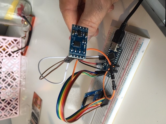

Hey folks. I fly rockets and dabble in arduino. Im trying to code the three items to my arduino nano and insert them into my rocket to collect data. I used the code from "bmg1234"(member), to join the SD card and the adxl345.
i need to add the code for the BMP280. individually I can read them on the computer, but combining them on the sd card is too hard for me to figure out.
In an ideal world i would also have the altimeter trigger my pyro charge to release my chute.
Any help would be great.
How are people supposed to help you when you don't share your code? Post your best effort at trying to incorporate your BMP280 into your current code along with any error messages you may be getting and people can help.
Good point, thx for the posting tip. I tried to upload and it gave errors: did not recognize Serial.begin(9600) there may be more but I did not gt past that one error.
I tried to fuse the BMP sketch with the already working sketch of the SD and adxl345.

Posting tip #2 - read the sticky post at the top of this forum and learn how to properly post your code inside code tags
so it looks like this
Again, it helps people help you. Please edit your reply and insert the code tags
Lots of error codes showed up by simply adding the BMP sketch from Adafruit. I have the BMP on order but I am trying to pre program the code for it. I've spent hours battling with this. I am following your site directions and read the forum steps to post code. Hope this works. ps: How can i quickly find my post and responses without a long search through all the topics? thx for giving me your time. Mark

Arduino: 1.8.12 (Windows 10), Board: "Arduino Nano, ATmega328P (Old Bootloader)"

'Serial' does not name a type
Invalid library found in C:\Users\mwatson\Documents\Arduino\libraries\blink_9_on_1_off: no headers files (.h) found in C:\Users\mwatson\Documents\Arduino\libraries\blink_9_on_1_off
This report would have more information with
"Show verbose output during compilation"
option enabled in File -> Preferences.
You can't have code outside of a function. If you look at the indentation of your code you will see lots of function calls, etc. outside setup() and loop(). It needs to be inside those functions

  Serial.print(F("Temperature = "));
  Serial.print(temp_event.temperature);
  Serial.println(" *C");
  Serial.print(F("Pressure = "));
  Serial.print(pressure_event.pressure);
  Serial.println(" hPa");
  Serial.println();
  delay(2000);
  Wire.beginTransmission(ADXL345);
  Wire.write(0x32);
  Wire.endTransmission(false);
  Wire.requestFrom(ADXL345, 6, true); // Read 6 registers total, each axis value is stored in 2 registers
  X_out = ( Wire.read() | Wire.read() << 8); // X-axis value
  X_out = X_out; //For a range of +-2g, we need to divide the raw values by 256, according to the datasheet
  Y_out = ( Wire.read() | Wire.read() << 8); // Y-axis value
  Y_out = Y_out;
  Z_out = ( Wire.read() | Wire.read() << 8); // Z-axis value
  Z_out = Z_out / 256;
  AngleData = SD.open("PTData.txt", FILE_WRITE);
  if (AngleData) {
    Serial.print("X= ");
    Serial.print(X_out);
    Serial.print("   Y= ");
    Serial.print(Y_out);
    Serial.print("   Z= ");
    Serial.println(Z_out);
    delay(250); //Pause between readings.
    AngleData.print(X_out);
    AngleData.print(",");
    AngleData.println(Y_out);
    AngleData.println(Z_out);
    AngleData.close();
Hi Karma. I tried to learn about the function calls but am unable to sort it out. is it a huge fix or a simple one for a knowledgeable Arduino person? Can you fix this for a fee or do you know a member who can do this for me? My battle continues. My rockets are grounded until I sort this out. Mark
