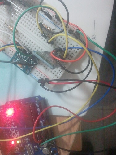

My wiring is as follows:
Arduino ADXL345
10 -> CS
11 -> SDA
12 -> SDO
13 -> SCL
3V3 -> VCC
Gnd -> GND

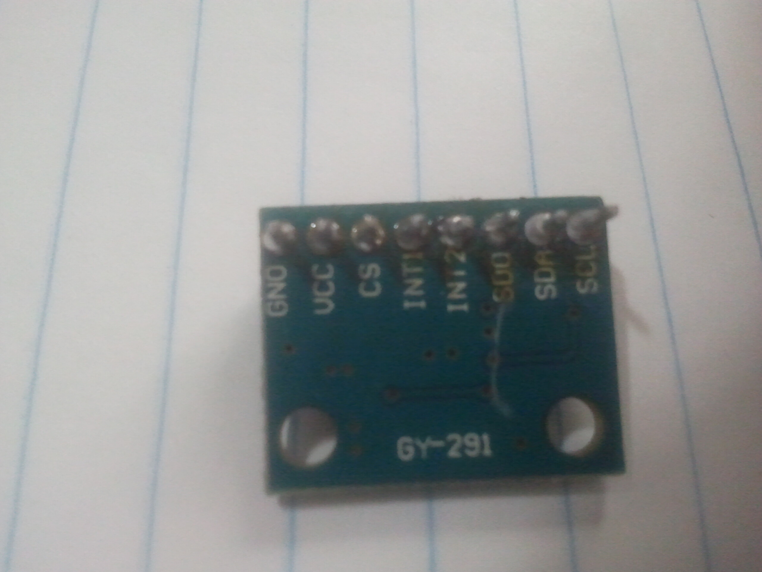

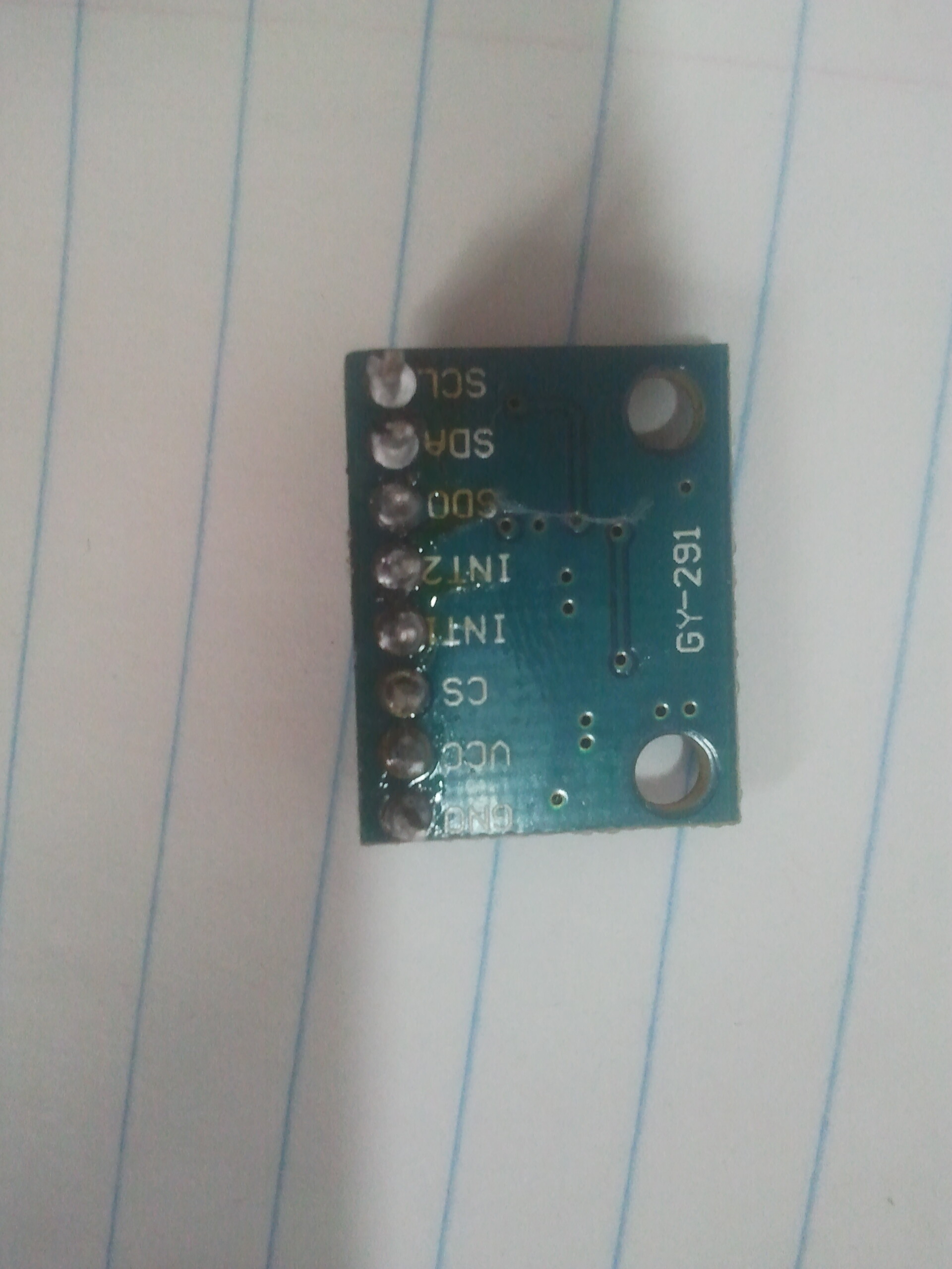

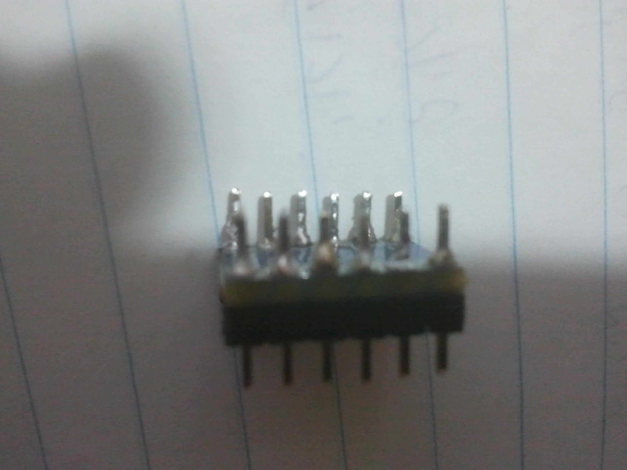

Edit:
I have added two pictures - the first to show that 10-13 pins are connected properly, and the second for the GND and the 3.3v.
Adafruit's tutorial on the ADXL345 seems more detailed, perhaps it will help: Overview | ADXL345 Digital Accelerometer | Adafruit Learning System
I appreciate the gesture, but the connection is I2C, when I'd like to connect it in SPI.
Though, it did helped me to understand why the alternating between 0,0,0 and -1,-1,-1, and that's because I didn't solder the board.
Your signal names are wrong. Look at datasheet for SPI signal names.
SDA & SCL are I2C signal names, NOT SPI.
SEE PAGE 15

ohh.. OK, then how should I connect it?
I'm not going to say anything more until you post your code instead of a link.
It should work with the logic level converter if you are using the wiring you linked for that .

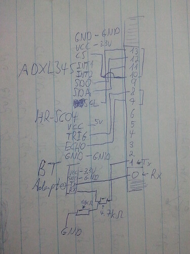

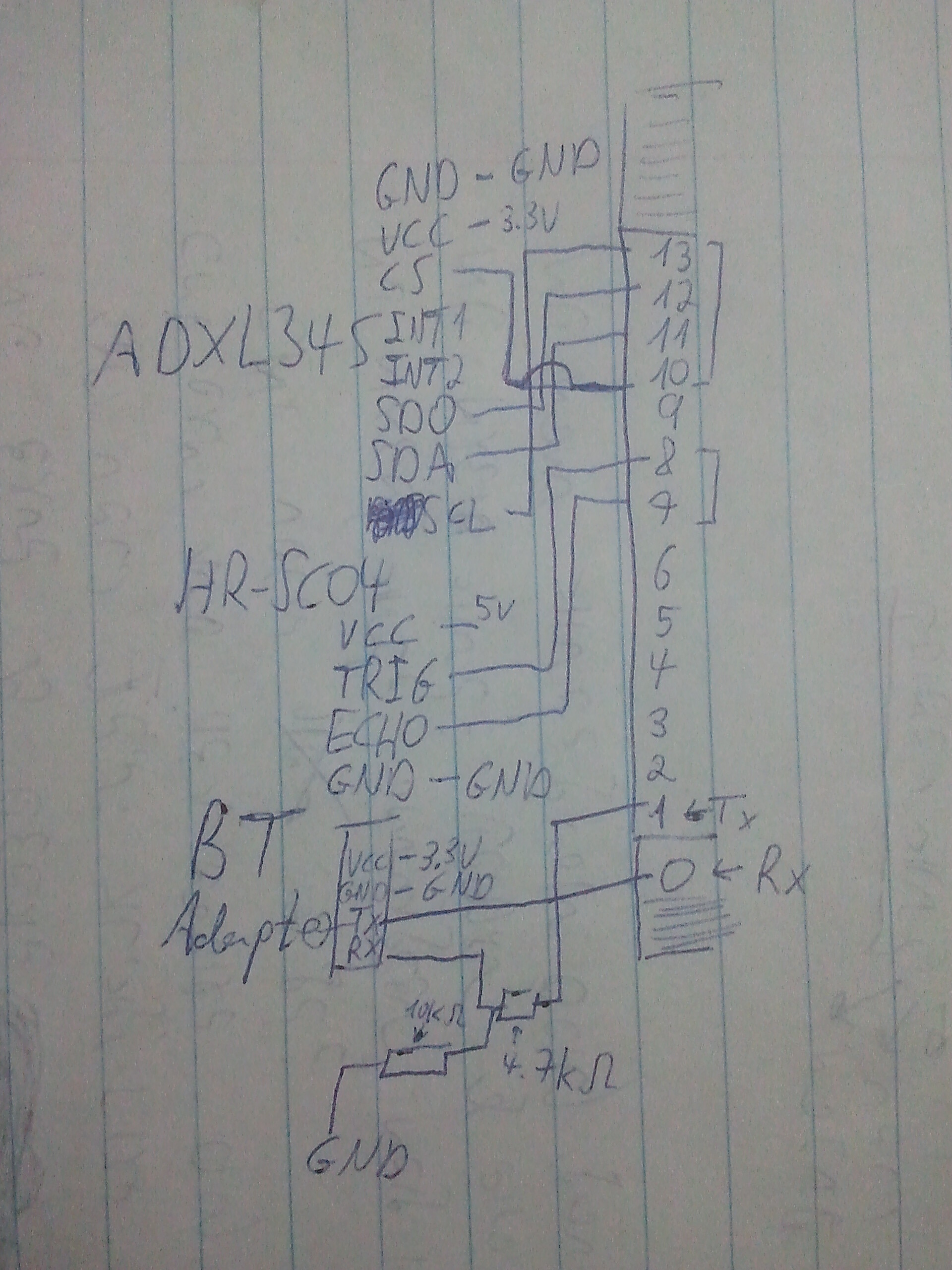

Can you hand draw a schematic of your circuit on a piece of printer paper and take a photo of it and post it ?
Include any resistors that are in your circuit.
Well, I can do all that, but first I would like to annouce that I didn't know that I should solder the board, meaning nothing worked.
Right now, the ADXL345 is working, with a lot of noise though, and the LLC is working properly(which, at a second thought, has nothing to do with this post actually..)!

    The wiring is really too basic to draw a circuit for, but I don't mind to post it if that's neccesary.. As I have read in the tutorial, those 10-13 digital pins are also used for the SPI connection, so I believe the wiring is ok. I would appreciate any help with all the false readings, which can sometimes remain constant for a second or two(not for all the axis's at once), and with the Z axis, which does not seem to have any logical outputs at all..

You're right. I have merged my own code into their basic tutorial code yesterday, and forgot to update you.
A friend of mine soldered the ADXL345 board and the LLC from the bottom of the pins. I suspect maybe that's why the ADXL345 outputs are so unstable, not to mention the Z axis..
I have added a picture of the bottom LLC soldering, and a very unprofessional scheme of my circuit.
I'd like to see a photo of the soldering from directly above the board instead of from the side.
These are the proper signal names . If you are using SPI, SDA & SCL don't exist . Those are I2C signal names. the SPI names are MISO & SCLK. Also, the SDIO pin on the ADXL is the MOSI SPI pin on the arduino . If you are using SPI you should know the proper signal names. The reason you see those names on the data sheet is because in I2C mode they apply, but in SPI mode the other names apply (SDIO and SCLK)
Arduino ADXL345

These are the best pictures I could get with my old phone.
And for JumpMaster, I could only say that my 0,0,0 issue was fixed by soldering the board, meaning a wiring issue.

The cs pun looks like it doesn't have enough solder. Did you do a continuuty check?
I don't know what that means, but I can ask my friend to solder the cs pin again.
