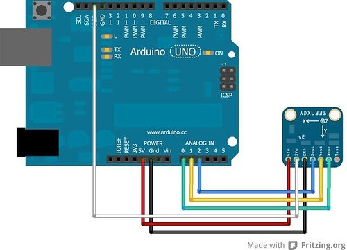

im using Adafruit ADXL377 shield and having a small trouble.
Im using the following code to adquire values from X,Y and Z and too scale them to 'g's':

Here what i receive in the serial:
X: 455
Y: 459
Z: 463
X: 22.09 g
Y: 20.53 g
Z: 18.96 g
X: 510
Y: 512
Z: 510
X: 0.59 g
Y: 0.20 g
Z: 0.59 g
Always the first measure has those peak g's why ?

Which Arduino are you using?
From AdaFruit's website
This breakout comes with 3 analog outputs for X, Y and Z axis measurements on a 0.75"x0.75" breakout board. The analog outputs are ratiometric: that means that 0g measurement output is always at half of the 3.3V output (1.65V), -200g is at 0v and 200g is at 3.3V with full scaling in between.
If you are usings a standard 5V UNO, and the Sensor is flat on a surface.
Z axis Raw should read: 339
X Axis Raw should read: 338
Z Axis Raw should read: 338
The Sensor outputs 0.00825 V per G. so Zero G is 1.65V, one G positive is 1.65825
If you are using a 3.3V Micro, and the sensor is flat on a surface:
Z axis Raw should read 514 = (1.65825/3.3)*1024
X axis Raw should read 512 =(1.65/3.3)*1024
Y axis Raw should read 512 = (1.65/3.3)*1024
Those first reading are way out. Post your actual, compiling code, and maybe I can find what is wrong.
base on your numbers, you are using a 3.3v Arduino. You probably need to null the sensor.
the 510 reading looks to be the 0g level.

Im using a arduino mega 1280, using exactly this conection:
How do i null the sensor ?
khaoz87:
Read the Sensor at a known acceleration. (i.e. not moving, fixed orientation) Y:512, X:510, Z:510
Calculate an offset from:
Sensor is lying with Y axis pointed away from EARTH Therefore Y Axis should read 1g
X and Z axes are parallel to the surface of Earth therefore they should read 0g
So I pick raw Sensor Value of 510 as 0g. That is what my previous example code did.
My corrections have those assumptions, If the sensor is oriented in a different manner, you will have to change my coding.
Also, you might have to create a specific null value fore EACH axis. Just orient the Sensor such that the axis under question is measuring Zero g. Then use that value for your 'nulling' value for that axis.
