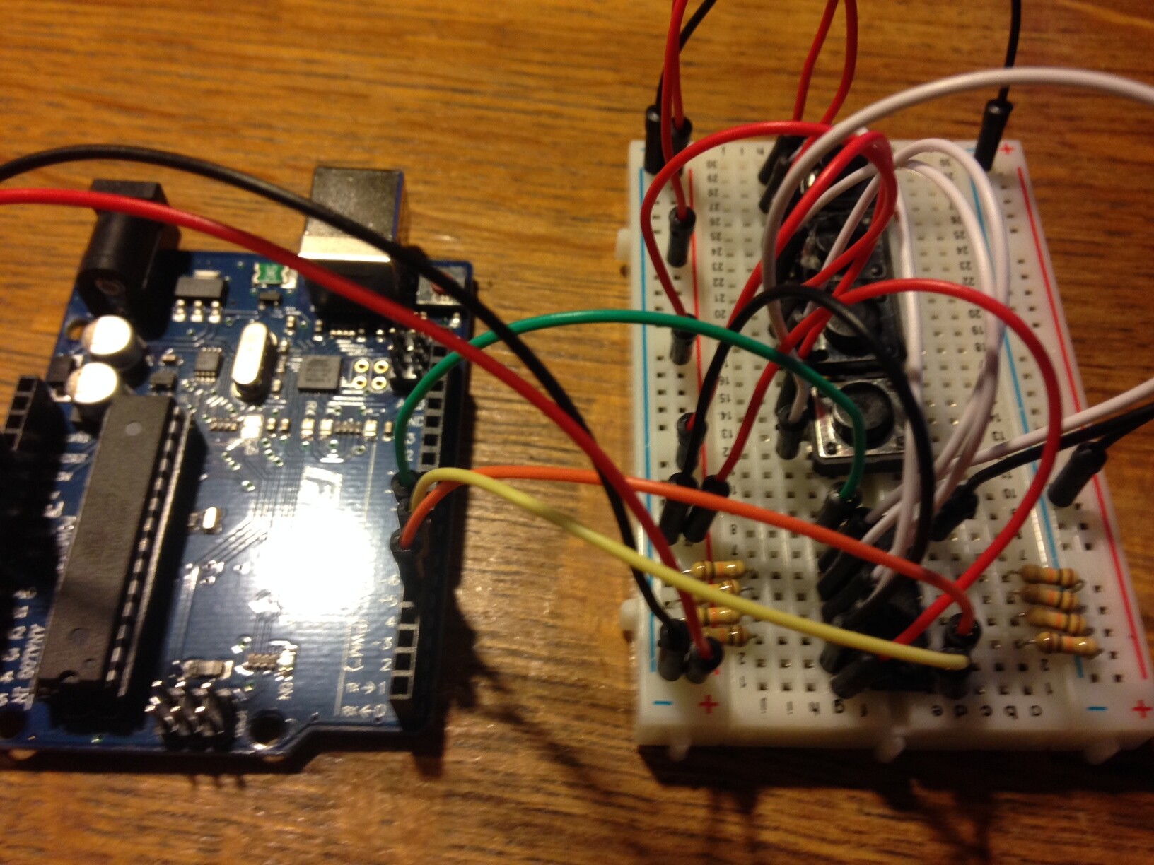

"Has anyone successfully used the 74HC165 with the build in shiftIn() routine?"
I had a setup with the CD4021 that worked perfect but now I have a bunch of 74HC165 chips for another project and I cant get it to work. This is what I used

As I said, it worked great with the 4021 but when I tried it with the 74HC165 I have no success. Maybe I am to noob to read datasheets but here is how I wired up the chip:
latch on Pin 1
clock on Pin 2
data on Pin 9
6V on Pin 8
GND on Pin 8
Pin 15 on GND
The Input pins with a 10KOhm accordingly.
Any help would be highly appreciated.
Alex
Found it. I used a bad sketch where the latch and clock pin was declared as Input.
I edited my code post to the right code, because it would perhaps confuse people.
