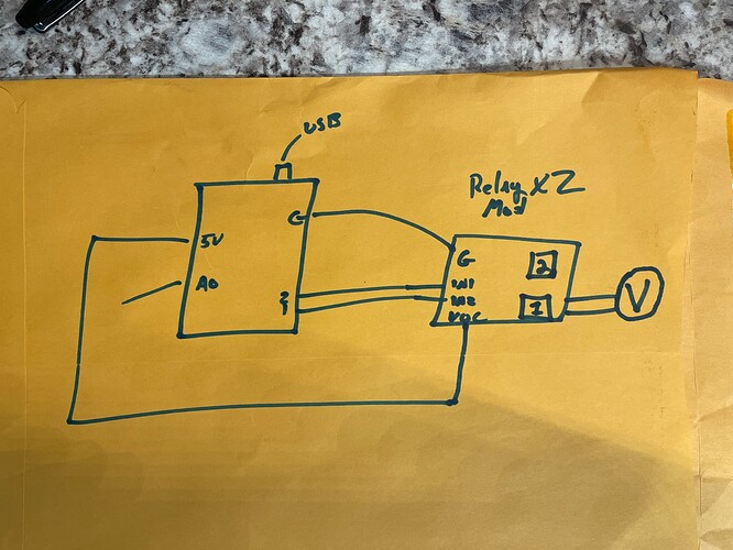

This is my first try at a project.
I have an air compressor that has undesirable condensate collecting in the tank. I would like to trigger a pneumatic relay valve via Arduino controlled relay.
I want the relay to open for 1/2 sec two times when the compressor start up current is detected on A0. After that the valve should remain closed (relay off) until the next start up.
The relay is getting stuck closed.
I should note I wanted to try and write code based on runtime of the compressor as detected by current sensor but I don't have the experience yet.
Any help would be great.

We have no way of knowing or even seeing how you have all this wired and powered. Please provide a schematic of the wiring, hand drawn is fine.

The LED indicator on the relay board is on. The relay board I have has 2 relays. I’ll try them both. Can you explain the placement of the Diode.

You have one of the relay signal wires connected to the Serial TX pin (pin 1) move it to another pin (NOT pin 0).
