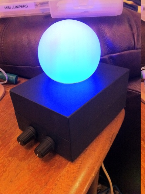

I've created a lamp for my son's nightstand that is a 1w blue HB led driven with a lovely constant current driver / PWM that I had laying about. I'm using analogWrite() to the driver's PWM pin to dim and illuminate the LED. When the LED is getting brighter, he's to breathe in. When it's getting dimmer, he's to exhale. At the valley between breaths, he's to not breathe (you know... like we all do all the time including you as you're reading this now. yes, you.)
The issue I have is that I've decided to go too big for my skills on it. I can make it work if I just control the brightness, but leave the timing of the breathing exactly the same because I know all the variables. I can make it work if I change the timing of the breath but the brightness is set.
The big issue is the increment in my analogWrite loop for inhaling and exhaling.
I need to get from 5 (my brightness floor) to X (my max brightness) in Y (in breath) milliseconds. I can simply change the delay to do this, but with SHORTER breaths, I might not get all the way to Y before running out of time if the increment is too small on my fade up loop. Alternately, if I increase the increment, but then increase the in-breath length, the steps might be HUGE and really noticeable on a long in-breath. We want the increments as small as possible to make it possible for 5 to get to X in Y milliseconds with a delay long enough for the PWM to register but not so long that it looks choppy. I'm going to throw up. I'll restate:
I need to get a formula that will give me the smallest increment and lowest delay necessary to get from 5 to X in as close to exactly Y ms as possible.
I'll use the same formula to calculate the outbreath. The pauses are not an issue.
I have a pot for brightness that is mapped to return 5-200.
I have a pot for breath length that is mapped to return 2000-9000 (as in the seconds necessary to complete one breath cycle)
In the end, this would run as a macro of sorts that will start him at a nice 5000ish range, then slowly slow down and help him get to sleep. This technique has been used in cases like his as an alternative to drugs (EEEK!).
I would appreciate any assistance you might be able to give on this problem. I know this is long and I'm almost certainly missing an important piece of information that will frustrate you folks. I'm just brain dead on this and I missed the cutoff to give it to him tonight, but would love it if he had it for tomorrow.
I've attached a photo - it looks much better in person. No you may not have my box of M/M jumpers.

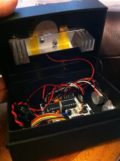

A couple things... Sadly, this product already exists in the USA, it just has a few problems. It's patented, closed source and designed for ADULT sleeping patterns. Children have a slightly higher respiratory rate, so I needed to make my own.
A couple interesting things about this one...
I'm using a 3W RGB common-anode LED for this. The red on this LED burned out a few months back, so I've been waiting for a project that would benefit from JUST blue or green (or a mix). It's mounted (see pic) to a bar of aluminum and then heatsinks are mounted to IT. This is VAST overkill, but the box is actually cardboard... Just being careful. As an example, it's been running at max peak and max breath for over an hour and the bar directly under the LED is at 73F according to my IR thermometer. That's 1 degree above ambient.
I'm driving the LED with this constant current driver:
http://www.dealextreme.com/p/mr16-1-1w-320-350ma-constant-current-regulated-led-driver-8-40v-input-13553
The fun bit about this driver is that you can get VERY good PWM results by applying output from the Arduino to the PT4511 pin 1. For less than $2, it's a really great driver. I remove the MR-15 pins and the H-bridge, solder on some .1 pins and toss it right on my perfboard! If I ever turn this into a more permanent product, I'll likely make it a single board solution with a SMD atmega, the ON SEMI CAT4109 RGB driver (LOVE this chip - best design I've seen in years), a white/brown/pink noise maker/mixer and a clock with a low power LCD built in (the low power version of this: http://www.mdfly.com/index.php?main_page=product_info&cPath=40_60&products_id=201). I'd throw it all into this little 150x150x50mm box I have with a li-ion battery and turn it into a nice travel sized unit :slight_smile:
I'd also like to take this moment to thank Modern Device (http://www.moderndevice.com) for what has VERY quickly become my favorite Arduino. The BBB is just amazing. It's cheap enough that I don't mind deploying it, has enough thoughtful additions (nobody includes the dang inductor!), and is flexible. I proto on one in my breadboard then often (not in this case, just because I will be adding more) solder directly on to the board. I will usually cut small holes in a piece of acrylic for each of my wires, cut mounting holes in it, mount my BBB to the acrylic then use the Dale Wheat stress relief technique (http://www.dalewheat.com/) to make sure my connections last forever.
edit: note that the kapton tape is only there to hold the heatsink in place while the adhesive cures.
