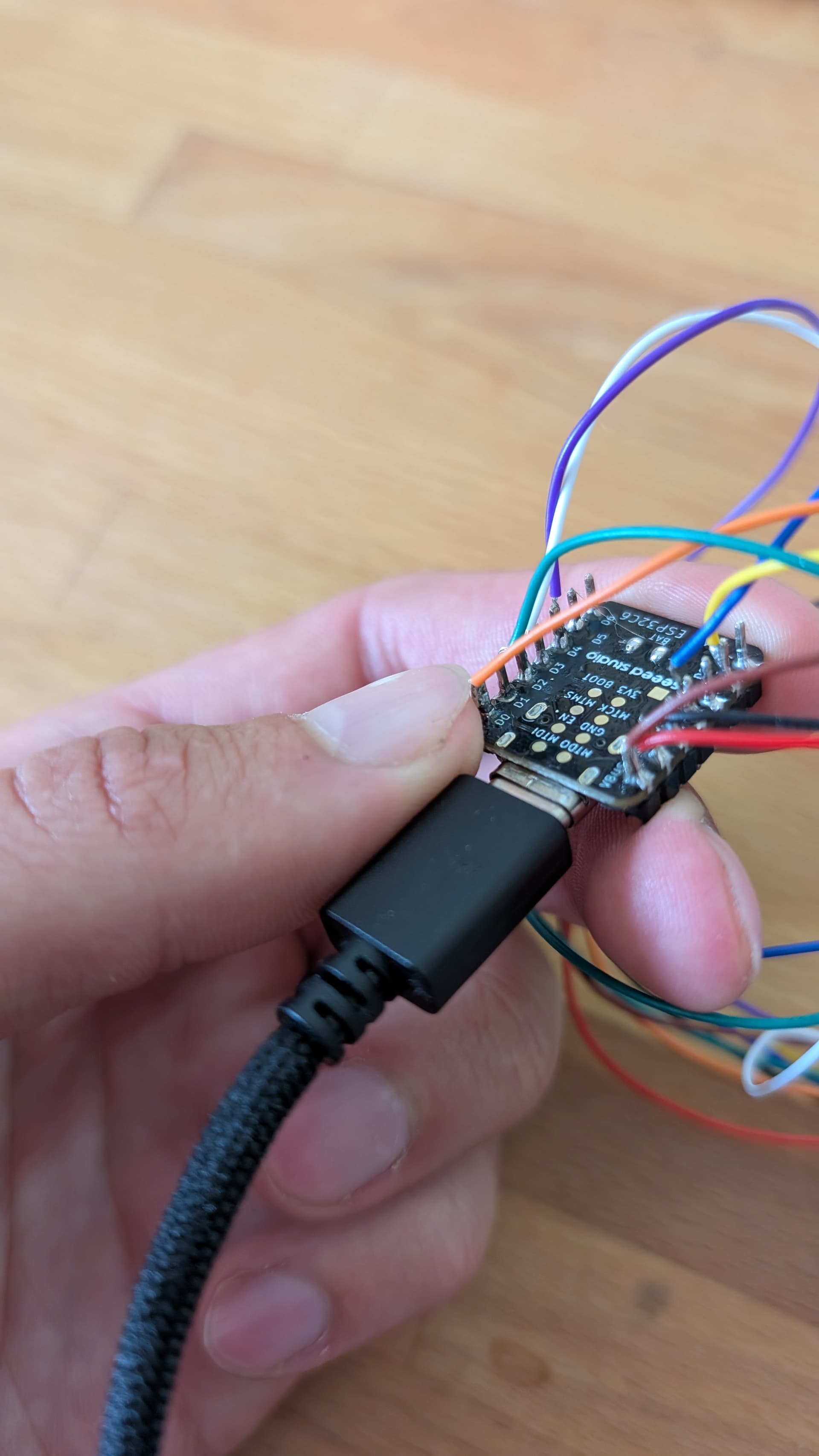

Hello, I have a 7.5" 800x480 epaper screen from aliexpress and I can't get it to work with GxEPD2 and waveshare driver hat adapter.
aliexpress link
I have very simple code from GxEPD examples.
#include <GxEPD2_3C.h>

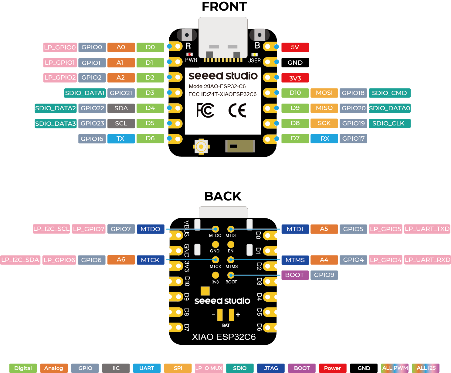

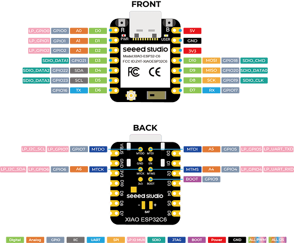

// Overview of Waveshare e-Paper HAT connection to XIAO ESP32C6:
// Signal on e-Paper HAT | Pin on XIAO ESP32C6 | GPIO on XIAO ESP32C6
// VCC (or 3.3V, VIN) | 3V3 | -
// GND | GND | -
// DIN (or MOSI) | D10 | GPIO18 (SDIO_CMD)
// CLK (or SCK) | D8 | GPIO19 (SDIO_CLK)
// CS (Chip Select) | D0 | GPIO0 (LP_GPIO0)
// DC (Data/Command) | D1 | GPIO1 (LP_GPIO1)
// RST (Reset) | D2 | GPIO2 (LP_GPIO2)
// BUSY | D4 | GPIO22 (SDA / SDIO_DATA2)
GxEPD2_3C < GxEPD2_750c_Z08, GxEPD2_750c_Z08::HEIGHT / 4 > display(GxEPD2_750c_Z08(/*CS=D0*/ 0, /*DC=D1*/ 1, /*RST=D2*/ 2, /*BUSY=D4*/ 22)); // GDEW075Z08 800x480, GD7965
//display.init(115200); // default 10ms reset pulse, e.g. for bare panels with DESPI-C02
display.init(115200, true, 2, false); // USE THIS for Waveshare boards with "clever" reset circuit, 2ms reset pulse
// comment out next line to have no or minimal Adafruit_GFX code
display.setTextColor(GxEPD_BLACK);
display.firstPage();
do
display.fillScreen(GxEPD_WHITE);
display.print("Hello World!");
while (display.nextPage());
void loop() {};
This is what I have from serial monitor:
ESP-ROM:esp32c6-20220919
_PowerOn : 6
_Update_Full : 2
_PowerOff : 2
But nothing more. The display is not responding. Busy pin is high. Voltage is 5v stable. PWR pin is high too.
Does anyone have experience with a similar display? or what would you advise me?
I have ESP XIAO C6.

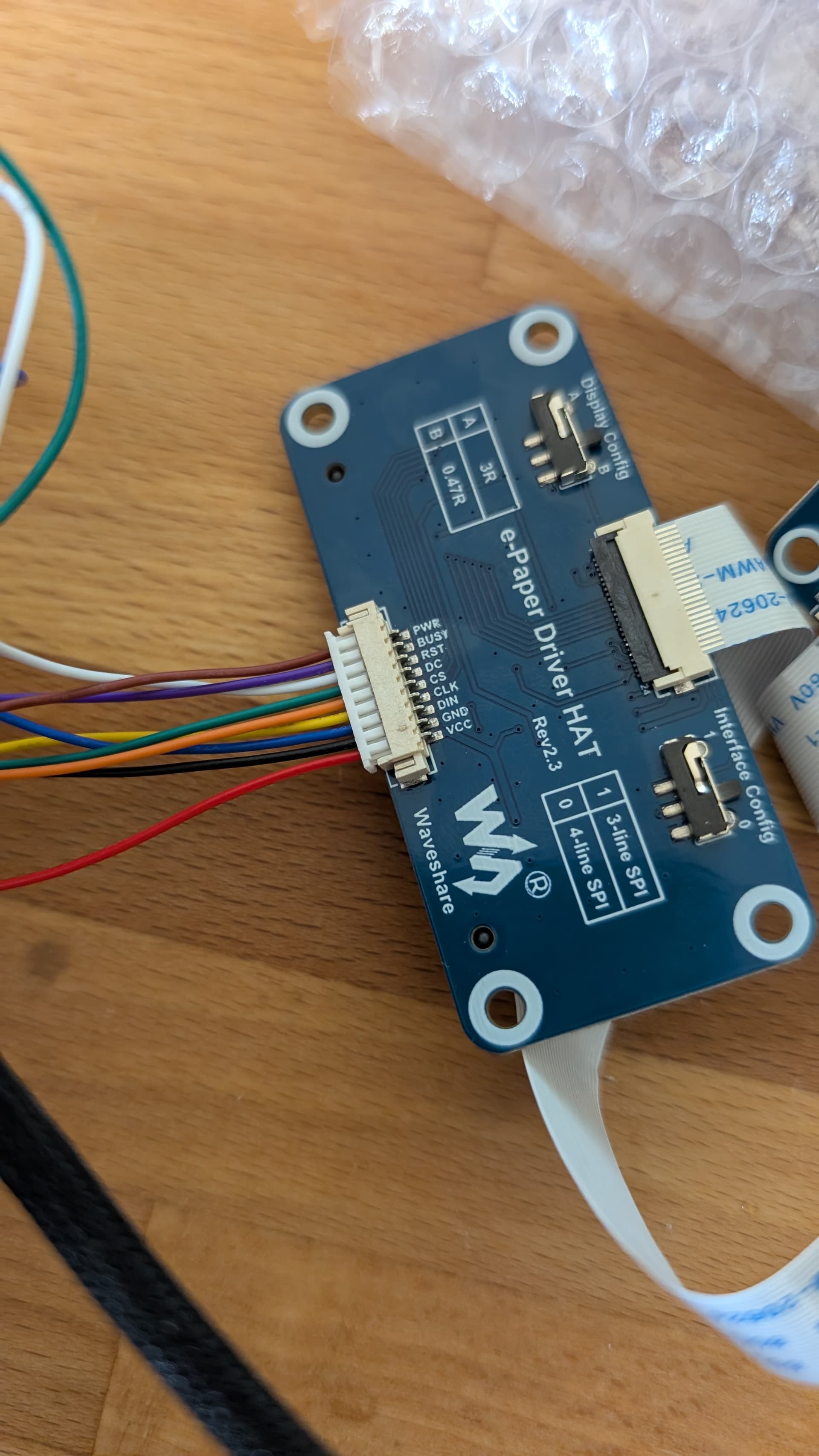

If you read the pinned post re 'How to get the most from the forum', you will learn about how to post code.

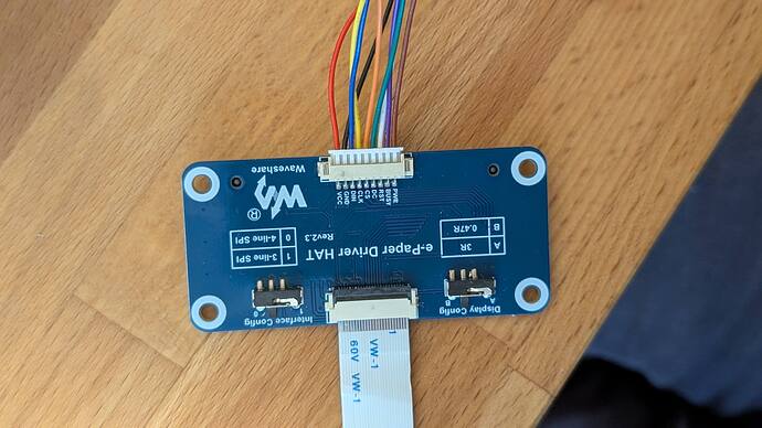

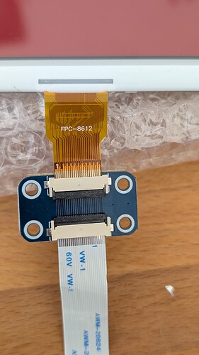

After you read that, look very carefully at the cables and where they make contact with the clamps. Note the numbers on the cables and/or the cable clamps, it looks like at least one is wrong.

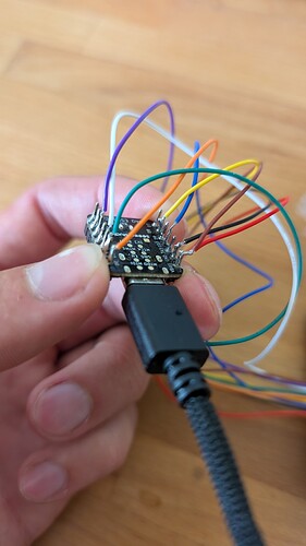

I edited the original post, I apologize. I also added detailed wiring diagrams commented in the code.
I have it connected to 5V now because on 3v3 it gives busy timeout. But the adapter should handle it according to the specifications. 3V probably can't deliver that much current and that's why it doesn't work, I don't know.
I have now triple-checked all the connections again and everything is fine.
@suke001 I found all the parts on Waveshare and it looks like you got it cabled right. Can you eliminate the one board and cable and connect the screen directly to the driver board? Also make sure those cables are FULLY seated, mine make a distinct click when they are inserted correctly.

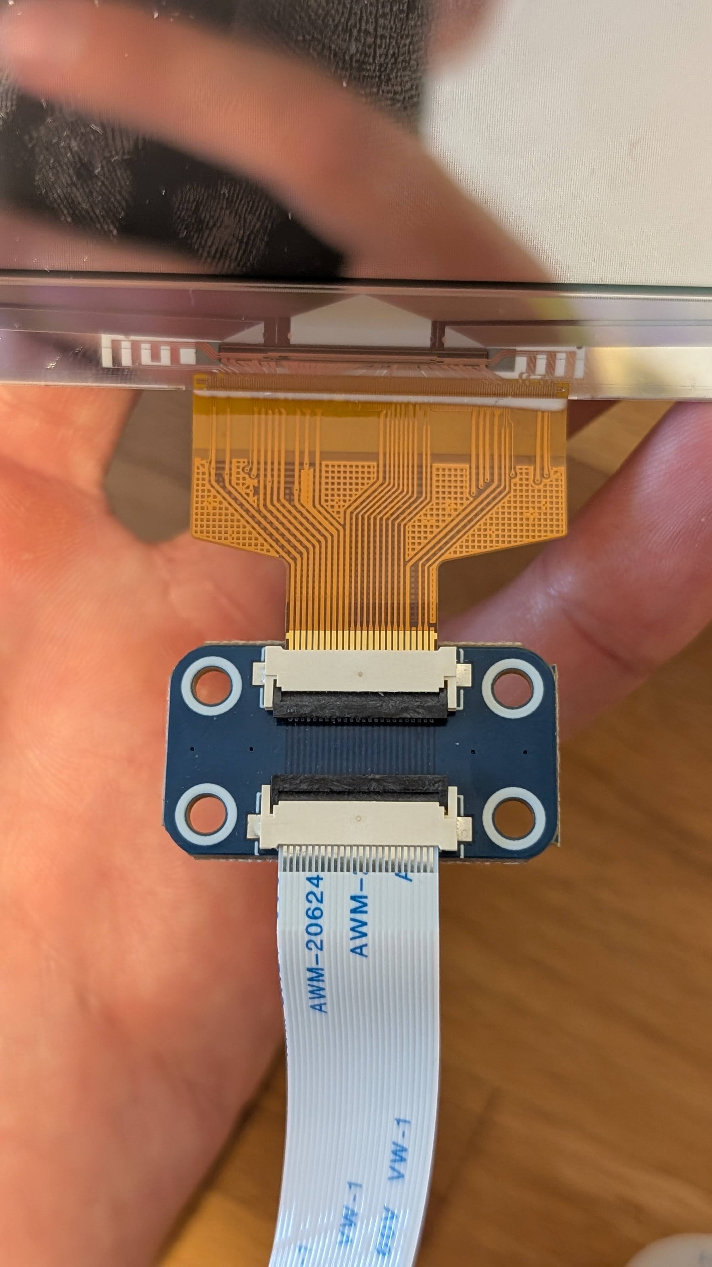

Yes I tried connecting the display directly to the hat without an extension.

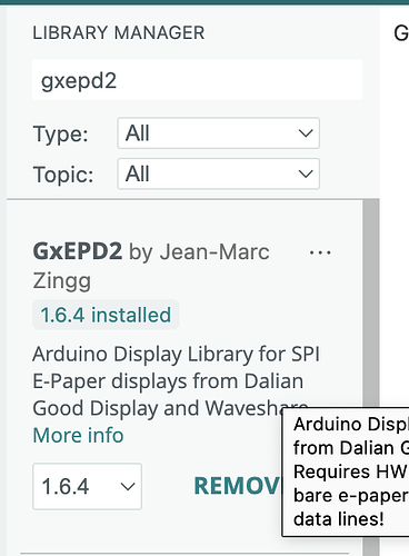

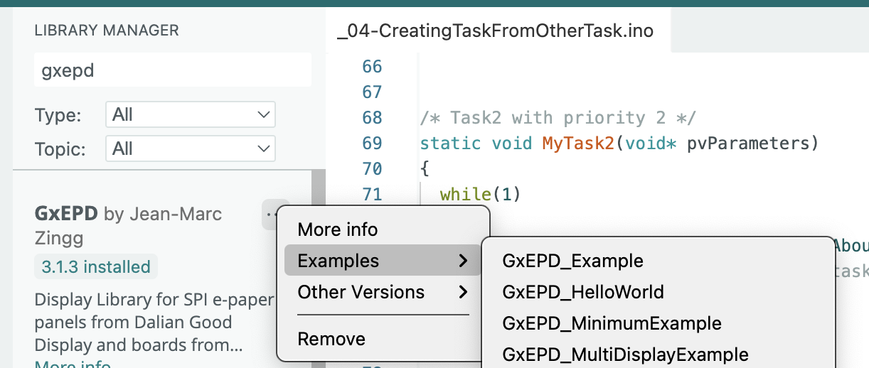

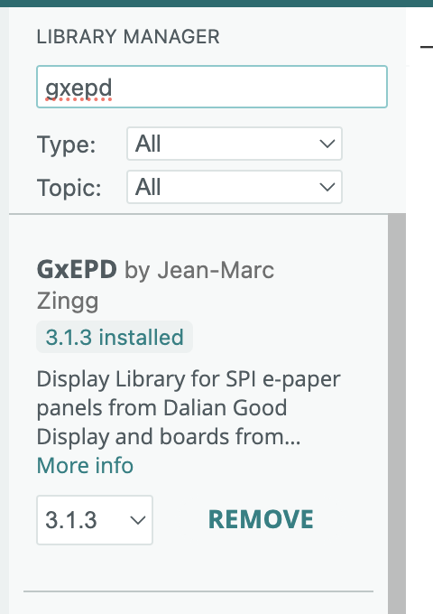

Do NOT use Github, it looks out of date. Here is the minimum example from the Arduino Library Examples. Now we have to wonder if the official library is different from what you are using. At the end are screen shots of what found NO github.
// GxEPD_MinimumExample by Jean-Marc Zingg
#include <GxEPD.h>
// select the display class to use, only one, copy from GxEPD_Example
#include <GxGDEH0154D67/GxGDEH0154D67.h> // 1.54" b/w
#include <GxIO/GxIO_SPI/GxIO_SPI.h>
#include <GxIO/GxIO.h>
// constructor for AVR Arduino, copy from GxEPD_Example else
GxIO_Class io(SPI, /*CS=*/ SS, /*DC=*/ 8, /*RST=*/ 9); // arbitrary selection of 8, 9 selected for default of GxEPD_Class
GxEPD_Class display(io, /*RST=*/ 9, /*BUSY=*/ 7); // default selection of (9), 7
display.init();
display.eraseDisplay();
display.drawPaged(drawHelloWorld); // version for AVR using paged drawing, works also on other processors
void drawHelloWorld()
void loop() {};
and examples

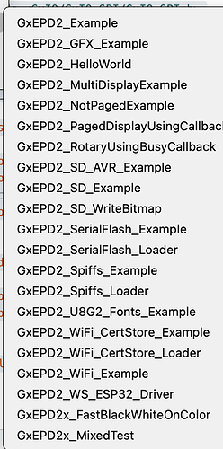

This is GxEPD I am using GxEPD2. That's why the code is different.
The author of the library is trying to help me, but it probably won't get me anywhere.
If I use 3V3 then i got Busy timeout errors and 0V on busy pin.
github discussion

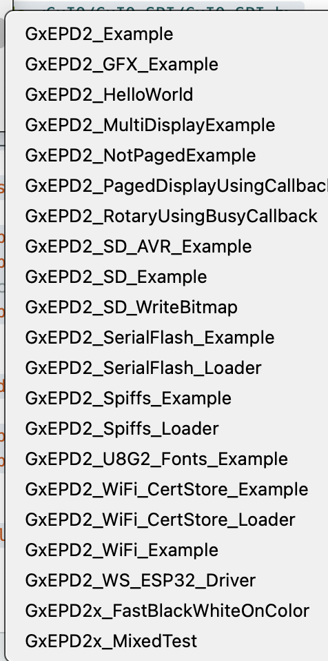

Which example. NOTE I did NOT use github, this is in the Library Manager.
Make sure to read the commets in the examples and make the changes they demand.
There are a total of 6 files in the example see below.

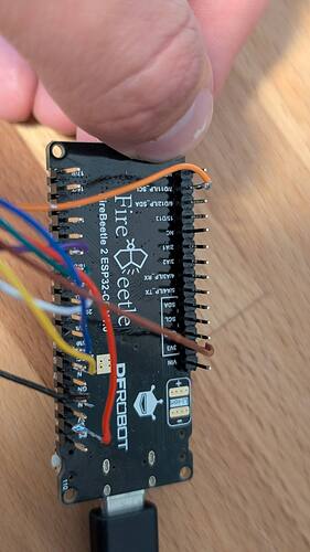

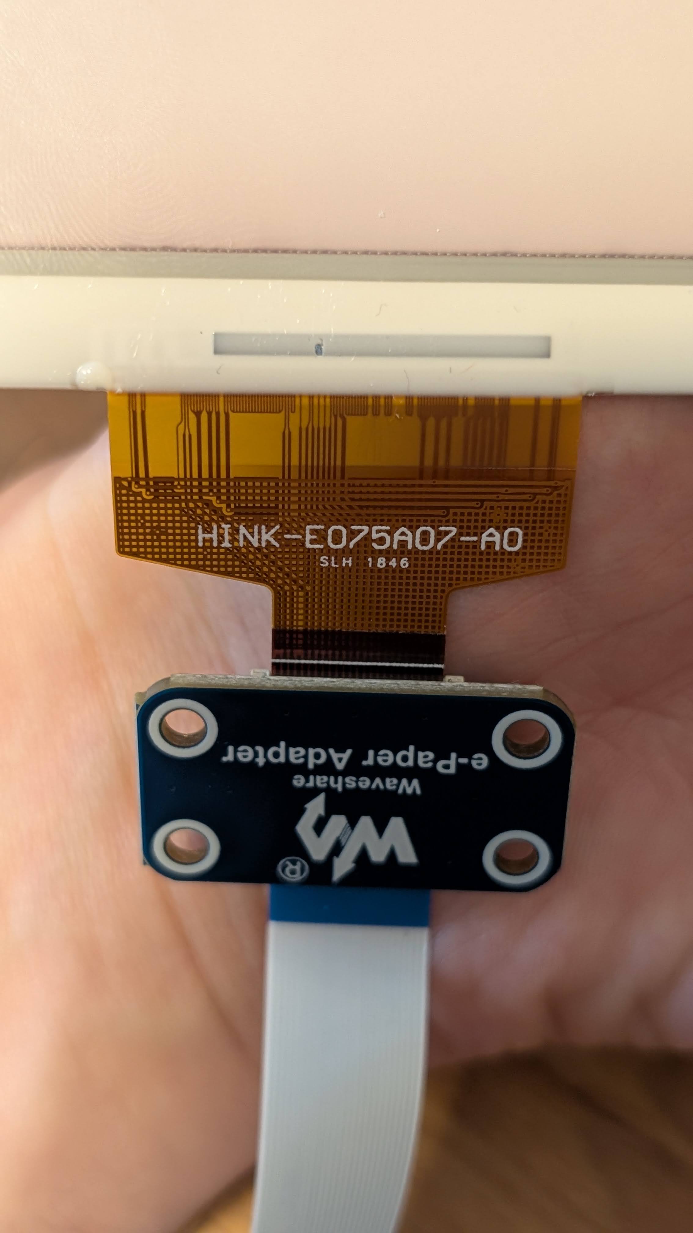

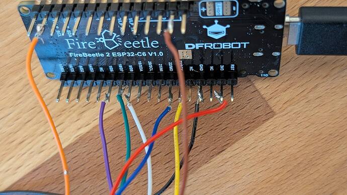

So I bought a new display, hink e075a07. I connected it to a new esp32 Firebeetle2 C6. And it doesn't work for me again, as much as I love e-paper displays...I also bought DESPI C02 and it doesn't work either..
Please can someone give me some advice? I'm really clueless. The display does nothing.
serial monitor:
Setup starting (FireBeetle C6 - 3C Quarter Paged Mode)...
Display initialized.
_Update_Full : 2
Hello World displayed function called.
Setup done, display hibernating.
// PWR <--> 3V3 (Power 3.3V)
// VCC <--> 3V3 (Power 3.3V)
// GND <--> GND (Ground)
// DIN <--> GPIO 22 (SPI MOSI)
// CLK <--> GPIO 23 (SPI SCK)
// CS <--> GPIO 7 (SPI Chip Select)
// DC <--> GPIO 18 (Data/Command Select)
// RST <--> GPIO 9 (Reset)
// BUSY <--> GPIO 1 (Busy Signal)
