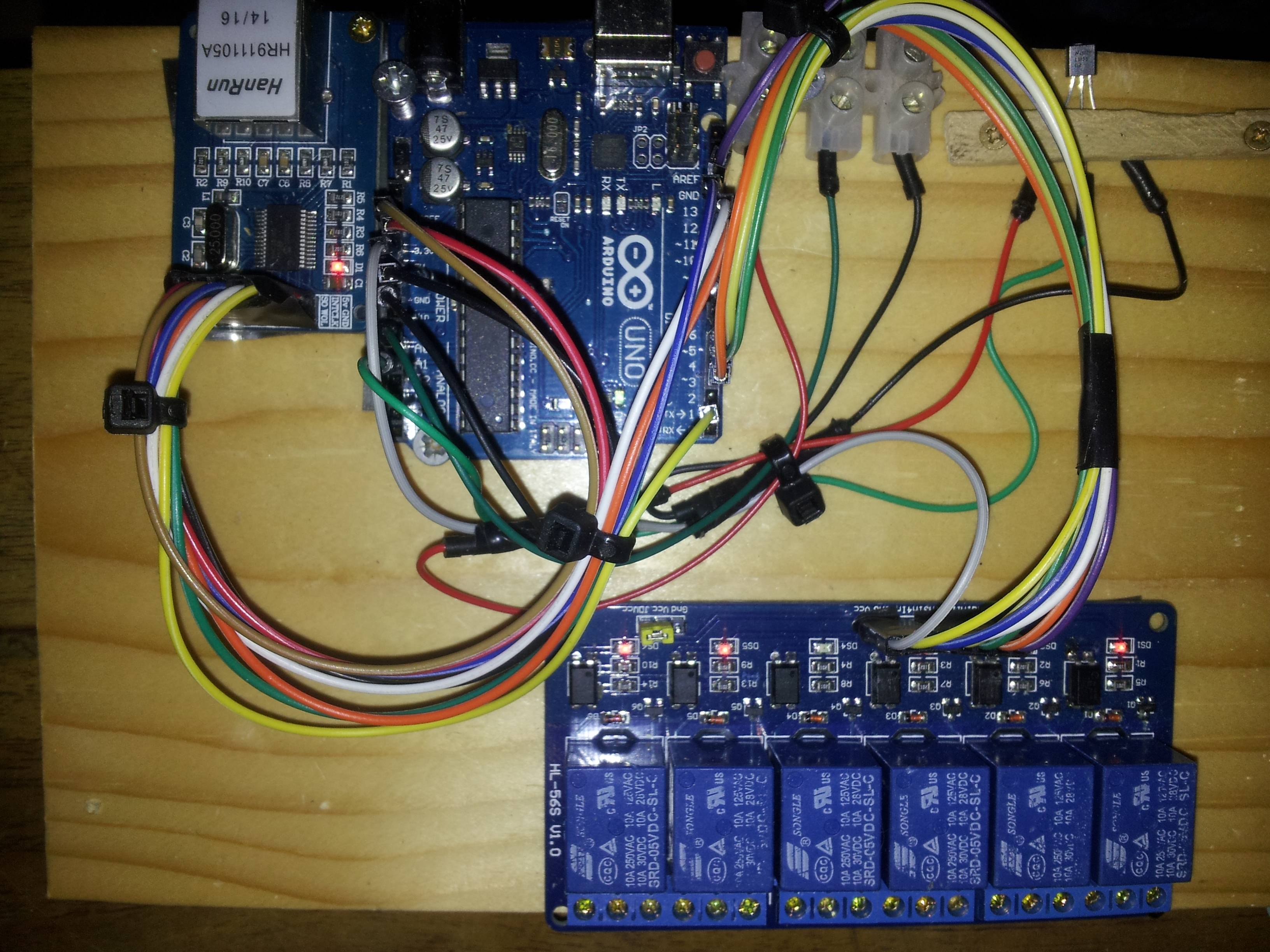

So I have an arduino uno, connected to env28j60 lan a 6 relay board and 2 temperature sensors (LM35).
I build a simple webserver in it so I can control it even while the complete system with multiple arduinos is not finished yet.
I have a problem that more starters have on the internet. When I switch a relay the voltage seems to drop and this effects the reading of the LM25.

can you post a photo\specs\webpage of the ralay board? it will be very helpfull
if the relay board must be powered at 5V you can use a 12v power supply and power the arduino, the same powersupply will go also to a heatsinked 7805 that powers the relay board
common ground (of course)
Of course i can post a photo.
Imgur
Don't mind the wood i have ordered abs cases.
I would like to power this.
I can try the option with the 7805 and 12v.
but i tried already a 12v 1000ma adapter and the ardiuno went on but no lan no serial communication.

your project is more good looking than those of mine but i can only "suppose" you are powering the ethernet module with the arduino 5V output, if so IT MUST power on the ethernet module when 12V is applied on the Vin

that s how i hooked it up to the arduino.

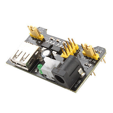

But I saw they are selling a breadboard 5V + 3.3V power supply too.
This in combination with a double usb loader (2A in total) should be sufficient and more power efficient, right?
The breadboard power supply is not more efficient. It has two linear regulators, similar to 78xx. You need a switching regulator.

It's not more efficient, but if I use the breadboard power supply to power the enc28j60 ethernet module and the relay module and I use the USB of the Arduino to power the arduino with the sensors.
Then at least I should be safe, right?
It should not become too expensive to buy, it should not be unsafe so my house burns and it should not be consuming a lot of power since it's 24/7 on.
That's why I thought of a double USB power supply with 2 usb cables powering the breadboard power supply and the arduino. It's handy since the breadboard power supply supplies 3.3v and 5v. and I need 3.3v for the enc28j60 and I need 5v to power my relay board.

powering that regulator module with 5V is useless, if you power the arduino directly with 5V you can power the relays with another 5V pow.sup. and you just need a 3.3 low-dropout regulator for the eth. module (you don't need an entire pow. module)
