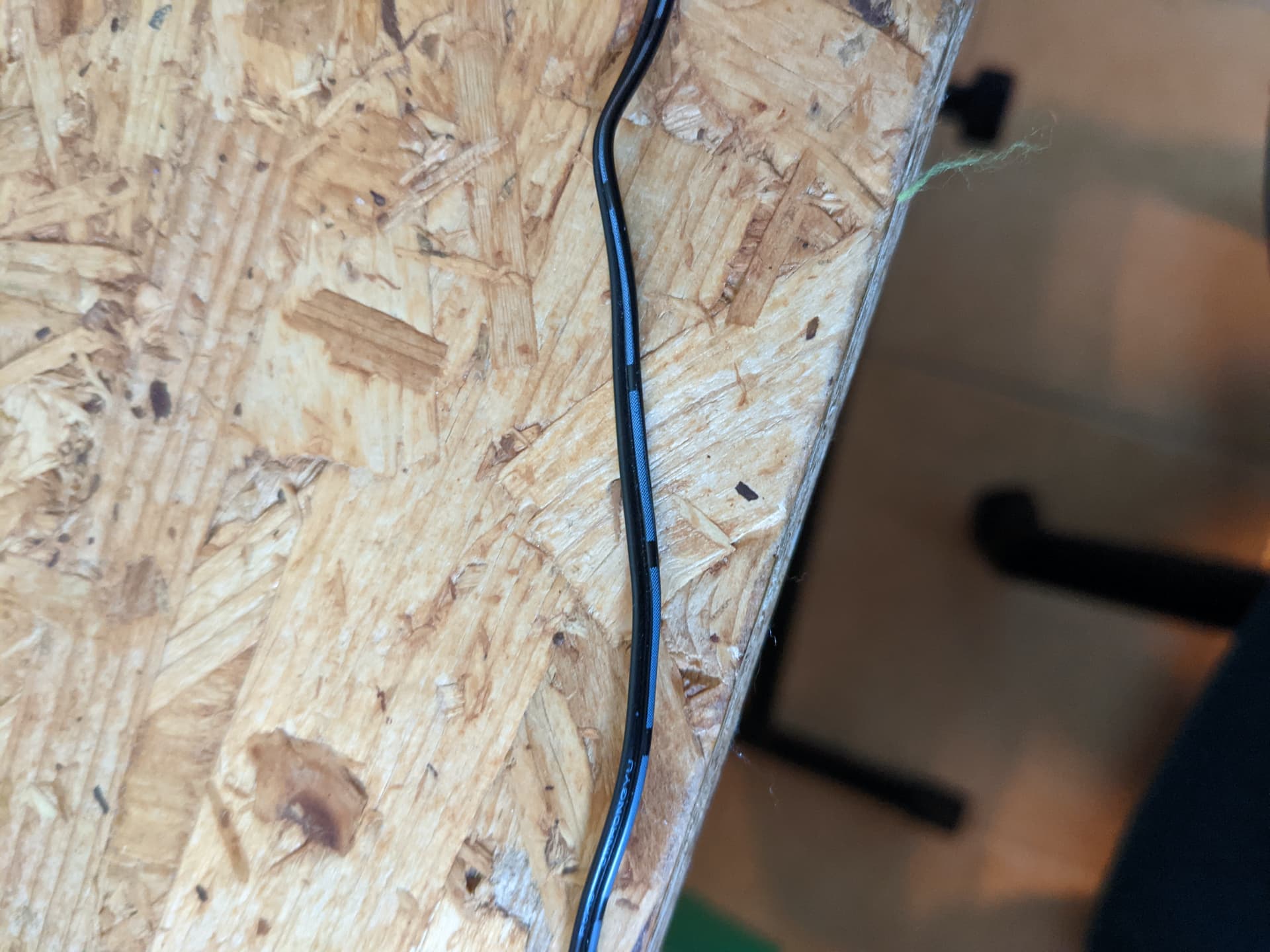

edit2: this is the solenoid I'm using:
one wire have a dashed white lines and the other is mainly black with some writing on it
How can I know the polarity of that type of solenoid? (I bought it from eBay and nothing was specify regarding the polarity)

Could it be my solenoid have no polarity? or all solenoid have polarity?
It depends on if the moving part is magnetised or not. Normally they are not so you just get an electro magnet being made which pulls the plunger into the field. When the current is removed the spring pulls the plunger out. So normally no polarity.
In that case a diode across it with the cathode at the + connection is still needed?
Of course it is still needed, it is an inductive load after all.
Generally not, unless it already includes the diode. :thinking:
I doubt your does, but if it does you may find out the hard way. :astonished:
