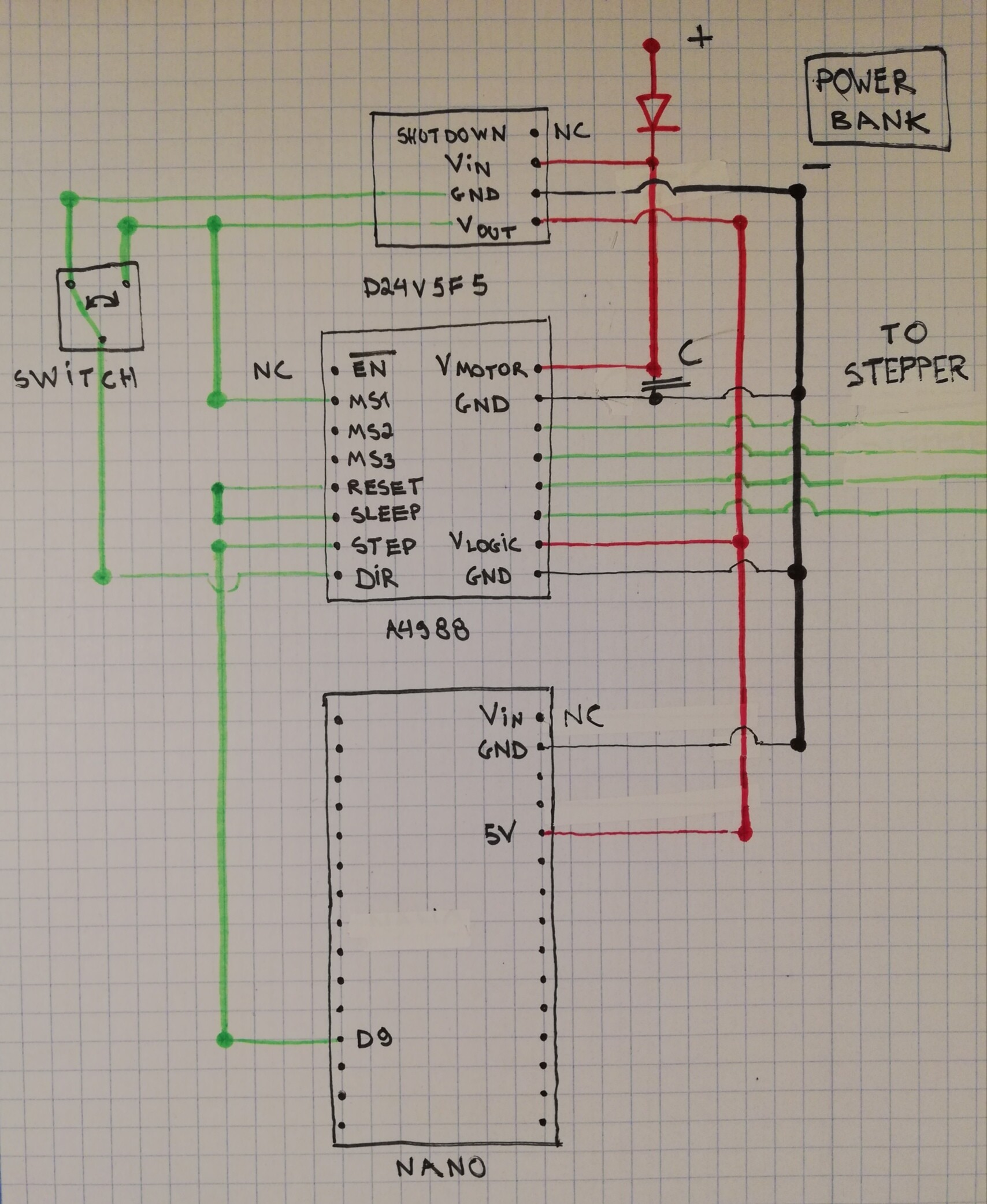

I'm building a barn door tracker and I use an Arduino Nano and a stepper motor. An Arduino should never power a stepper motor directly so I use an A4988 chip. Both the Nano and the stepper motor driver are powered by a 12V power bank.
I do this by sending 12V through the port that says VIN. The driver also gets 12V. All the Nano has to do is send pulses to the driver to tell it when to move the stepper motor by 1 step. For months I've had 0 problems but I just charged my power bank and it's sending 12.4V to the Nano instead of the usual 12.33V when it's not completely full.

The voltage regulator on most Arduinos is very limited and best not used at all. Use a good quality step down converter to produce 5V for the Arduino and feed it in the 5V pin, as well as the 5V pin on the motor driver (if required).
Make sure that you use secure screw connectors, or solder the connections from the motor windings to the motor driver board. DO NOT use a breadboard for motor connections, as the tracks will burn!
Loose motor connections generate very high voltage spikes that destroy things like Arduinos and motor drivers.

I think I got it guys. I just bought this: Pololu 5V, 500mA Step-Down Voltage Regulator D24V5F5 This looks like something that I could connect easily. I don't really care about efficiency because my battery pack has 6Ah but this looks like it's good quality stuff. I'll give an update if my projects succeeds (or after I blow up the next Arduino Nano).
The regulator on the nano is a rice-grain sized piece of garbage at best.
There are lots of things I'm totally comfortable with on clone boards, but trusting that the dirt cheap manufacturer in china used a regulator at least as capable of handling input voltages a few tenths of a volt above the nano's spec'ed maximum is not one of them.
Also, as a point of advice, if you let the smoke out of one board when you connect a new part (the new power bank. in your case), the correct thing to do is say "woah, there's something about this new part that isn't okay here. I don't know why, but I'd better figure it out", not "let me try it again with four more spare boards" Good thing nano clones are cheap!
If the problem was that you were juuust under the voltage that was enough to trash the regulator before, and that 0.07v is enough to push it over the edge, then a trio of diodes in series would totally work. Hell, even ONE diode would - though I would never be comfortable with my supply being within a fraction of a volt away from letting the smoke out of my parts, so I'd reach for 3 too if I was going to do that
A 5v linear regulator would be my first choice, though (be sure to use input and output caps per it's datasheet spec; if it only specs a 0.1uF cap on input, add like a 10uF electrolytic on the input too for board level decoupling - with the 5v regulated output going to the 5v pin (the nano has schottky diode between USB 5v and Vcc, so that's safe). Switch mode converters are great if you care about efficiency, or need significant current, and so on - but the nano itself - assuming there's nothing that's drawing a significant amount of current from the 5v rail (which I'm pretty confident is the case, since there's no way that regulator could have powered much of anything with 12v input before), I default linear regulators - they're dirt cheap, dead simple, and you can build them from parts rather than having to buy assembled modules.
That all aside, this raises some read flags for me. I would be really surprised if that measly 70mV was enough to make the difference between "works long term" and "fails instantly", and do so consistently among 5 boards with may well have different provenance.... Are you sure nothing else was connected incorrectly? You didn't reverse the polarity accidentally by any chance did you? Because THAT will trash things instantly, and the nanos are NOT protected against that.
Another brief aside - the only board I've smoked in over a year was a nano clone. That schottky diode I mentioned in series with USB power is so wimpy that - unlike most boards, where a short on USB power will just result in the computer turning off the port, the diode will burn out instead. I get away with shorting USB serial adapters out constantly :stuck_out_tongue:

Could be that OP had 5volt power to the Nano from USB, and and un-powered load (motor) on the V-in pin.
Back-powering through a regulator is a great way to kill a regulator. Clone or otherwise.

Can you post a circuit diagram of how you had the Nano connected to the motor controller, motor and power supplies?

All right here's how I wired it up after including a 5V step-down voltage regulator as you guys suggested. I ran a 20-minute stress test with a new Arduino Nano, driver and stepper motor on a new breadboard. No problems at all. The components don't even get warm which is surprising for components that normally run pretty toasty.
Here's the circuit:
Any thoughts?

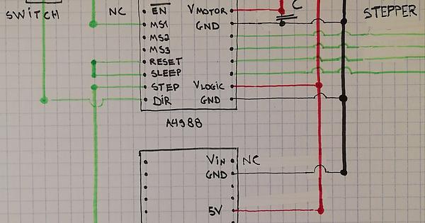

Can only see parts of the diagram without having to click away advertising (which I won't).
Why don't you post the image here.
Leo..
Here's the circuit
