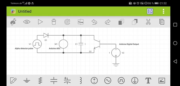

Hello guys,

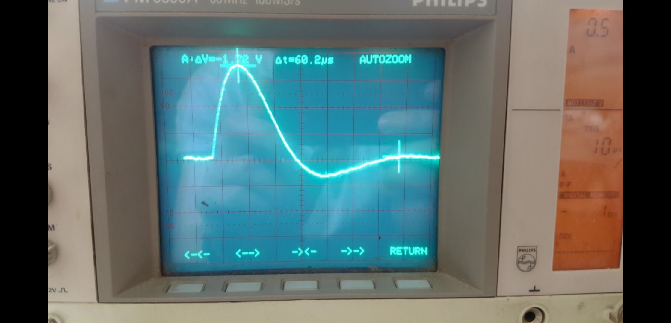

I am starting a new project for my university using an arduino board. The goal is to measure the energy of alpha particles (radioactive decay) using an alpha particle energy detector. I already have the detector, its sending pulses about 50 mikroseconds long (picture 1) and has a peak voltage of max. 4-5 volt (the absolute height does not matter, I only need relative heights to calculate the relative energies).

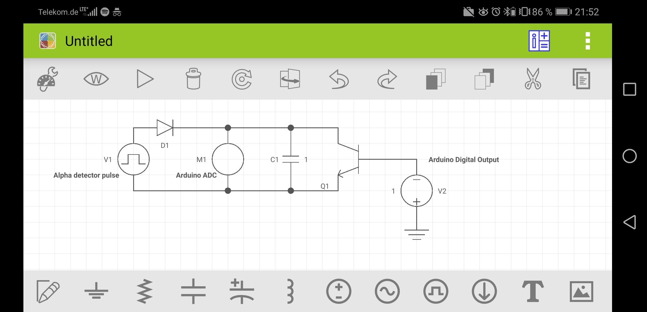

So my plan is on the one hand to measure this peak voltage using a capacitor and a transistor (picture 2) and on the other hand do stuff with the data like evaluate it, sync it with a cloud server etc. So the first question is: Does my circuit layout look okay? The idea is to store the peak voltage of the alpha detector using a capacitor, read it out using the ADC and then use the transistor to decharge the capacitor again. There will be less than 20k peaks during a half hour period, so the ADC read out frequency should be fast enough I think (?). According to google, the Arduino Uno can use its ADC about 10k times per seconds.

  1. What is the value of the capacitor? Surely not 1 Farad.
  2. What is the output impedance of the alpha detector?
  3. The default conversion time for the ADC on AVR based Arduinos is about 110 us.
  4. You need a base resistor on the transistor, value depends on type.
Actually measuring the total ev energy of an alpha particle will have a lot of assumptions. The numbers you supplied indicate that the pulse rate will average about 17 pulses per second. I assume you alpha detector out put pulse voltage is an indicator of the alpha particle energy. A capacitor in the detection circuit might just suppress the voltage you are measuring unless you are going with the voltage charge on the capacitor after it reaches a max charge. Maybe more info on your thoughts on the project operation.
I would use a faster ADC and just sample the detector output directly.
I use the ADC in the Teensy 3.2 to sample data at 100K SPS, 12 bits, and it works very well, with plenty of time left over for peak detection. The ADC could probably be pushed to 5x that speed.

I am not sure if I understood you correctly. My idea is that the sampling rate of the Arduino ADC is too low, therefore I want to "store" the peak voltage of the pulse in the capacitor. The arduino is constantly reading out the capacitor and if it reads out the same voltage for two times in a row (or maybe just once a voltage above 0,1V) it saves the value and decharges the capacitor. Then the capacitor is ready to "store" the next peak. You mean the charging and discharging of the capacitor will take too long?
@jremington
No, it is just for visualization. I am not sure about the size, but it should be rather small for fast charging and discharging iirc.
I am not sure, is it relevant? (I am "only" a physician and computer scientist, be patient pls :sweat_smile: )
ok thanks :slight_smile:
ok, so we don't want a too high current on the base if I understand you correctly. According to this, the transistor might blow up otherwise. Thanks for your remark :). I will have a look into that.
So the time resolution would be 1s/(100K*5)=2us (maybe higher with the teensy 4.0) which would be fast enough to measure the peak voltage. That would also make the circuit redundant and a master Arduino (or a Raspberry Pi then) could process the detected peaks further. The connection between the the two should be asynchronous, allowing the master to to his stuff while only reacting to detected peak voltages. Also the message sending shouldn't be too long, causing the sampling rate to slow down and not measuring the correct peak voltage.

You could Google "peak detector circuit". Or just sample the input fast enough to catch the peak.
For an example of a digital peak detector, look for any tutorials for an Arduino heart rate sensor.

  1. I am not sure, is it relevant? (I am "only" a physician and computer scientist, be patient pls :sweat_smile: )
Yes it is relevant, and required to know for proper design and function your circuit. The output impedance "R" of the alpha detector and the capacitor have an RC time constant, which must be correctly selected.
R can be estimated by placing a variable resistance across the output terminals and monitoring the output voltage. When that voltage drops by half, the variable resistance value is equal to the internal impedance.
  1. You are more likely to destroy the microcontroller output pin, if you omit the base resistor.

When you require those kinds of speeds then the analog peak detector circuit looks more suitable.
