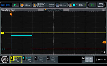

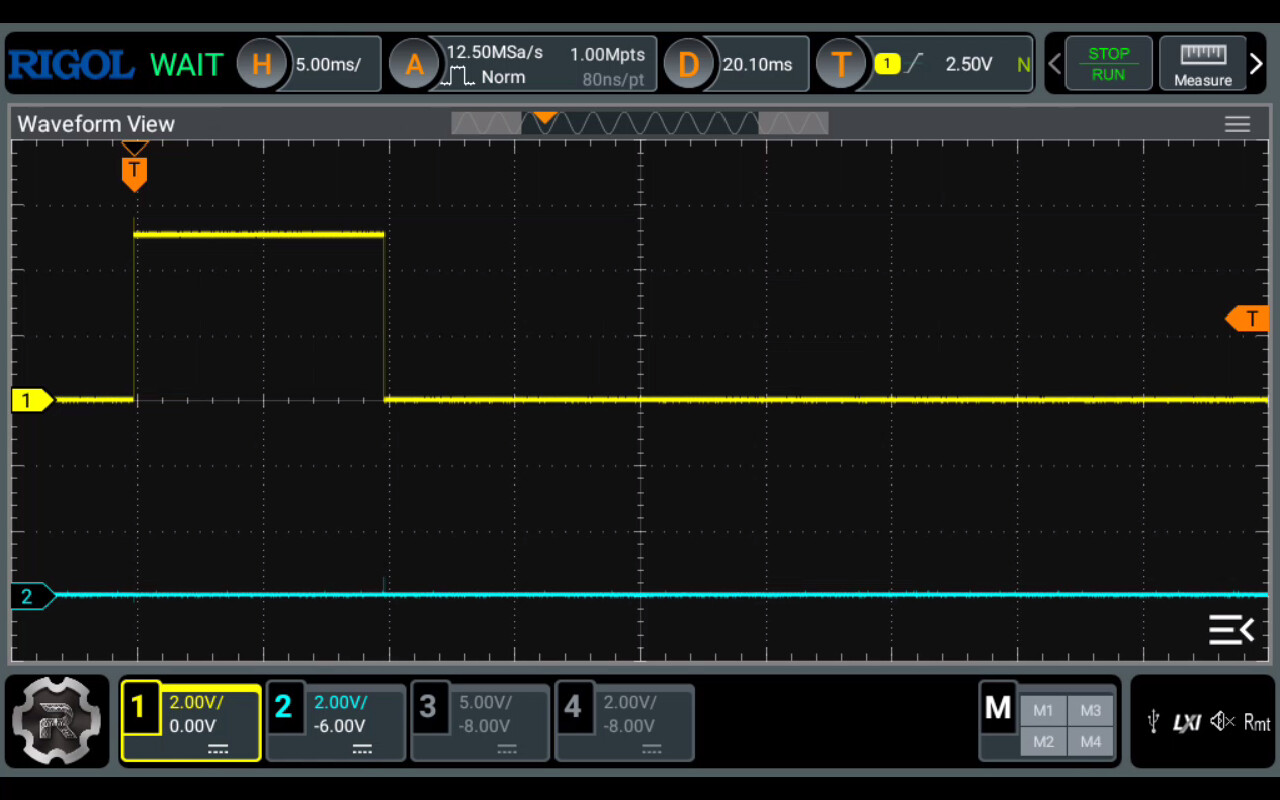

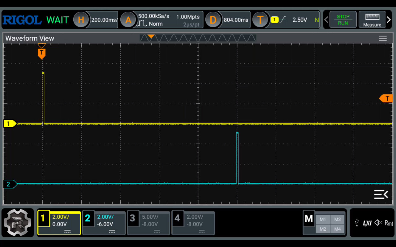

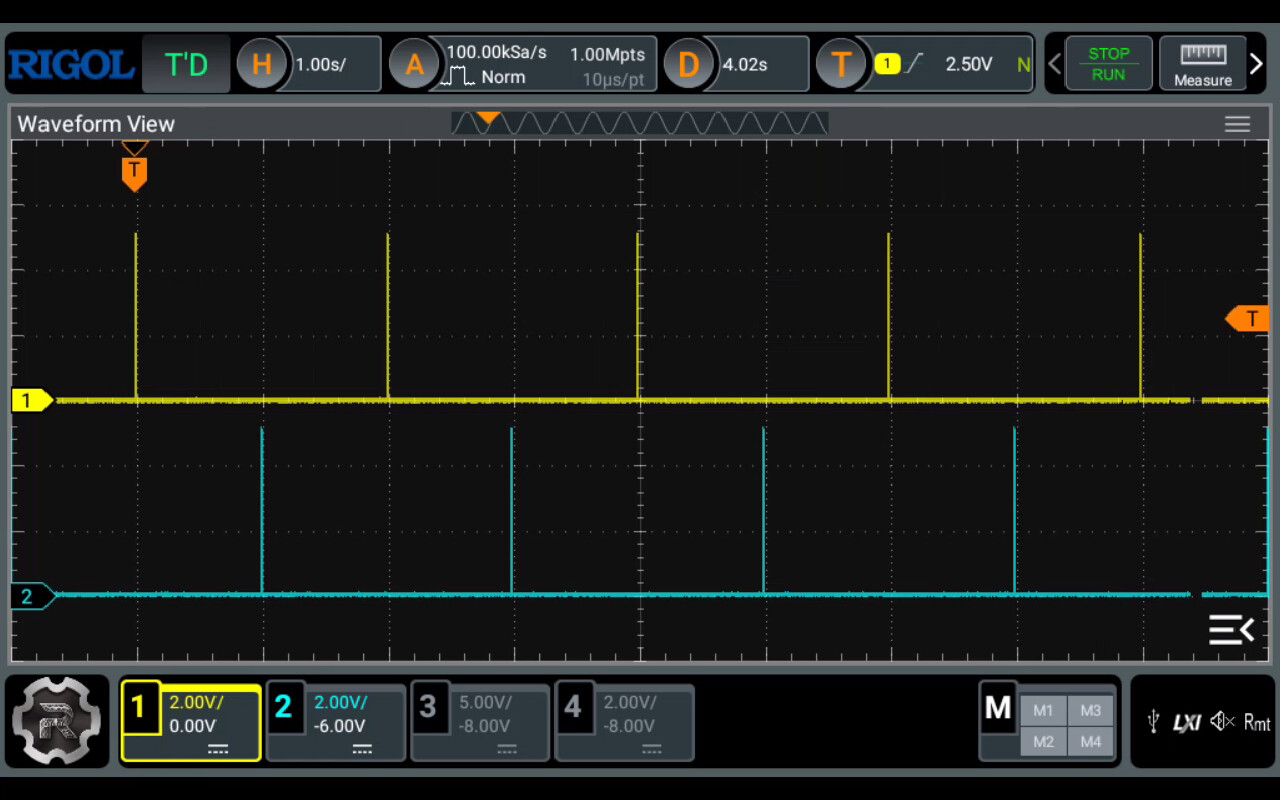

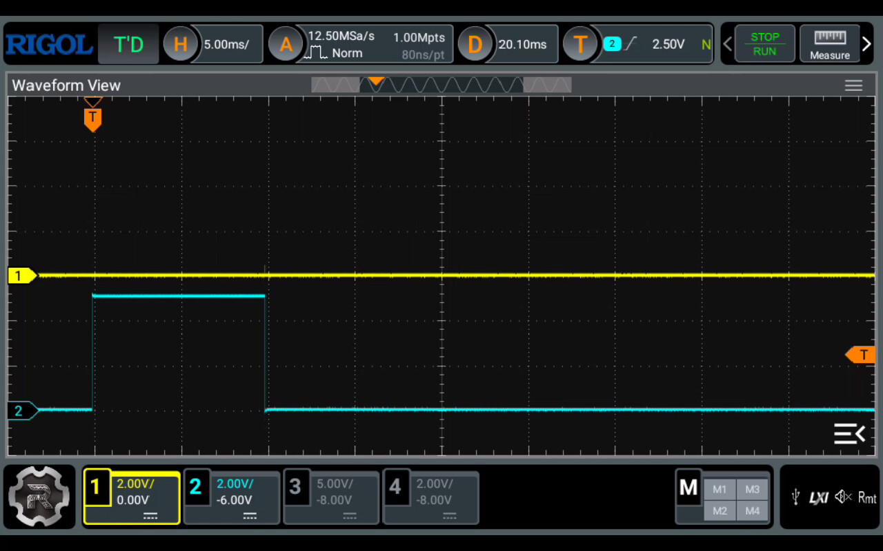

The LEDs will only flash for 10ms, this is probably too fast to see.
The code is functioning correctly,
See the oscilloscope traces below:
Timebase 1s/division.
Timebase 200ms/division.
Timebase 5ms/division, Pin 2.
Timebase 5ms/division, Pin 3.
You could try temporarily changing the delay(10) in the function doTick(), to delay(100) to make the flashes of the LED visible for test purposes.

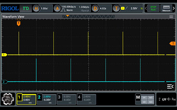

I have an update on my Arduino driven, pendulum regulated clock. I appreciate the help I have received. The code I ended up with an an attempt at a circuit diagram are included below. A couple interesting things:
I started with a pulse of 15 ms but that created wider pendulum swings than I wanted and the clock runs backwards.
I changed the pulse to 12 ms and the clock runs forwards but advances 2 seconds with each ticks.
When the pulse length is shortened to10 ms the clock again runs backwards with one second per tick (Pendulum length gives period of 2 seconds or 1 tick per second)
I may try playing with the code and change the pulse length each tick so we have a "two steps forward and one step back" which might be interesting.
I'd appreciate any thoughts on why the pulse length could be affecting the direction of movement for the clock
