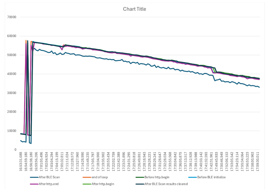

to continue my monologue, I found out that the issue has to do with memory leakage - apparently the SSL-stuf for the https-connection is using too much memory, if I understand the debug correctly:
21:17:53.265 -> [711103][D][HTTPClient.cpp:574] sendRequest(): request type: 'GET' redirCount: 0
21:17:53.265 ->
21:17:53.265 -> [711111][E][NetworkClient.cpp:319] setSocketOption(): fail on 0, errno: 9, "Bad file number"
21:17:53.265 -> [711120][D][NetworkManager.cpp:123] hostByName(): DNS found IPv4 172.217.19.78
21:17:53.265 -> [711127][V][ssl_client.cpp:68] start_ssl_client(): Free internal heap before TLS 63568
21:17:53.302 -> [711135][V][ssl_client.cpp:75] start_ssl_client(): Starting socket (domain 2)
21:17:53.333 -> [711183][V][ssl_client.cpp:166] start_ssl_client(): Seeding the random number generator
21:17:53.333 -> [711193][V][ssl_client.cpp:174] start_ssl_client(): Setting up the SSL/TLS structure...
21:17:53.366 -> [711201][D][ssl_client.cpp:192] start_ssl_client(): WARNING: Skipping SSL Verification. INSECURE!
21:17:53.366 -> [711210][V][ssl_client.cpp:288] start_ssl_client(): Setting hostname for TLS session...
21:17:53.366 -> [711218][E][ssl_client.cpp:36] _handle_error(): [start_ssl_client():298]: **(-32512) SSL - Memory allocation failed**
21:17:53.366 -> [711228][I][NetworkClientSecure.cpp:153] connect(): Actual TLS start postponed.
21:17:53.398 -> [711235][E][NetworkClientSecure.cpp:159] connect(): start_ssl_client: connect failed: -32512
21:17:53.398 -> [711244][V][ssl_client.cpp:360] stop_ssl_socket(): Cleaning SSL connection.
21:17:53.398 -> [711253][D][HTTPClient.cpp:1105] connect(): failed connect to script.google.com:443
21:17:53.398 -> [711261][W][HTTPClient.cpp:1421] returnError(): **error(-1): connection refused**
21:17:53.430 -> [711268][E][NetworkClient.cpp:319] setSocketOption(): **fail on 0, errno: 9, "Bad file number"**
21:17:53.430 -> Error on HTTP request: -1
21:17:53.430 -> Failed to connect to server. Re-initializing WiFi...
21:17:53.430 -> [711285][V][STA.cpp:214] _onStaEvent(): STA Disconnected: SSID: FRITZ!Box 7312, BSSID: 34:31:c4:76:f9:76, Reason: 8
21:17:53.470 -> [711296][V][NetworkEvents.cpp:119] checkForEvent(): Network Event: 14 - STA_DISCONNECTED
21:17:53.470 -> [711304][V][STA.cpp:110] _onStaArduinoEvent(): Arduino STA Event: 14 - STA_DISCONNECTED
21:17:53.470 -> [711312][W][STA.cpp:135] _onStaArduinoEvent(): Reason: 8 - ASSOC_LEAVE
21:17:54.509 -> [712371][V][STA.cpp:204] _onStaEvent(): STA Connected: SSID: FRITZ!Box 7312, BSSID: 34:31:c4:76:f9:76, Channel: 1, Auth: WPA_WPA2_PSK
21:17:54.541 -> [712383][V][NetworkEvents.cpp:119] checkForEvent(): Network Event: 13 - STA_CONNECTED
21:17:54.541 -> [712391][V][STA.cpp:110] _onStaArduinoEvent(): Arduino STA Event: 13 - STA_CONNECTED
21:17:54.541 -> [712397][V][NetworkInterface.cpp:78] _onIpEvent(): sta Got Same IP: 192.168.0.230 MASK: 255.255.255.0 GW: 192.168.0.1
21:17:54.573 -> [712409][V][NetworkEvents.cpp:119] checkForEvent(): Network Event: 16 - STA_GOT_IP
21:17:54.573 -> [712417][V][STA.cpp:110] _onStaArduinoEvent(): Arduino STA Event: 16 - STA_GOT_IP
21:17:54.573 -> [712424][V][STA.cpp:169] _onStaArduinoEvent(): STA IP: 192.168.0.230, MASK: 255.255.255.0, GW: 192.168.0.1
21:17:55.514 -> Connecting to WiFi...
21:17:55.514 -> WiFi Signal Strength (RSSI): -58 dBm

Hi, back again.
First I was pondering about the "string is the culprit" thing and thought, maybe using char is saving me some memory, but it seems as this is not doing much? I was trying it twice, not sure what I tweaked between the tests, but it doesn't seem to make much of a difference:

Next I was putting in
Serial.println("heap memory: " + String(esp_get_free_heap_size()) + " bytes");
all over the place before and after all critical steps with the following code:

OK, I am trying to analyze more what the memory is doing and I can't get my head around it... that's why I made that chart.
At first the heap, before I start with http.begin, is decreasing with every loop slightly, once it comes below around 7800-8000, http stops working.
It can recover a few times in the next loops, but eventually the memory is too low and http stops working completely.
This is where free heap suddenly rises back to 58k or something, but http does not come back and heap gets smaller every loop. Where does the memory go?

  delay(5000);
  googleURL_with_parameters = googleURL + "&HEXin=" + HEX_inside_sensor + "&HEXout=" + HEX_outside_sensor;
    //Serial.println("URL: " + googleURL_with_parameters);
    if (WiFi.status() == WL_CONNECTED) {
      Serial.println("LOOP Before http.begin: heap memory: " + String(esp_get_free_heap_size()) + " bytes");
      http.begin(googleURL_with_parameters);
      Serial.println("LOOP After http.begin: heap memory: " + String(esp_get_free_heap_size()) + " bytes");
      int httpResponseCode = http.GET();
      if (httpResponseCode > 0) {
        response = http.getString();
        Serial.println(httpResponseCode);
        //Serial.println(response);
        //Serial.print("Error on HTTP request: ");
        //Serial.println(httpResponseCode);
      http.end();
      Serial.println("LOOP After http.end: heap memory: " + String(esp_get_free_heap_size()) + " bytes");
      //Serial.println("Error in WiFi connection. Re-initializing WiFi...");
      connectToWiFi();
  HEX_inside_sensor = "";
  HEX_outside_sensor= "";
  delay(5000);
  Serial.println("LOOP end of loop: heap memory: " + String(esp_get_free_heap_size()) + " bytes");
