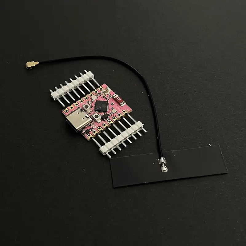

Note that the Seeed XIAO version of the ESP32C3 has a better build quality and it has a builtin charger and LiPo battery connection. Well worth a few dollars more.
It also comes with a stick-on aerial.

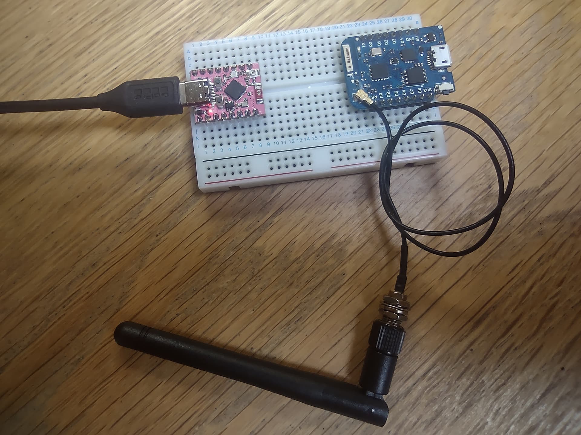

My ESP32 Supermini C3 arrived today. So far, so good!
I tested its wifi sensitivity, using its built-in antenna.

For comparison, here are the results for my Wemos D1 mini pro using its built-in antenna, in the same position:

and the Wemos D1 mini pro using an external antenna (maybe 3dBi, I can't remember):

I need to figure out how to configure the C3 super mini to use an external antenna. Any idea, anyone?
This post gives a clue. I can't see your board in details. Some of them already have a zero ohm resistor connecting the 2 antennas. Never tried it myself.
Thanks for the link, but it looks wrong to me.
If you did what they are suggesting, the external antenna and the built-in antenna would both be connected at the same time. That would result in having the wrong impedance connected to the chip, which would give a poor result and possibly damage the chip, I think.
Perhaps it's also important to remove the built-in antenna when you make that link.
just solder/swipe off the red aerial first.
It's just a piece of double-sided circuit board with a 3-4 turn coil etched on it.
It's only electrically connected on one side, the hot side. The other side is just for support.
Too bad you didn't get the Seed XIAO ESP32C3. It's smaller, shielded has external aerial included and more.

Hard to imagine the XIAO is smaller than this thing! The C3 supermini also came with a stick-on antenna, I'll test it later and compare it to some others I have.

Conclusions so far about the ESP32 C3 Supermini plus:
  1. ESP32C3 will indeed wake from internal RTC timer :slight_smile:
  2. Current consumption in Deep Sleep will not be an improvement on my current solution of Wemos D1 mini pro + ATtiny85 :frowning:
After today's testing, I agree! Considering purchase of the XIAO now. On Temu, where I purchased the C3 Supermini Plus, the XIAO is about 3x more expensive. But maybe worth it for my purposes.
