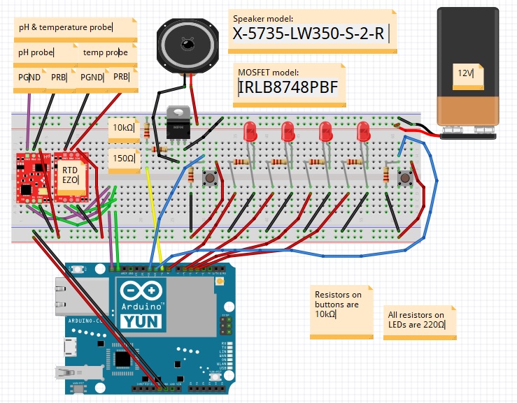

Unplug the yellow wire from the Arduino, and plug it into the ground rail (top/blue rail) of your breadboard.
So I re-ran my test set-up having not changed a thing other than pulling the MOSFET out and plugging it right back into the same spot and MAGICALLY it now fully stops making noise whatsoever when the pin is pulled low in between the high states. I'm not sure what matter of sorcery has befallen me, but it seems to be functional now....hopefully it STAYS this way...
Prime suspect here is the "solderless breadboard". The FET has much chunkier leads than pretty much any other thing you plug in, so on a poor breadboard - a common discussion point here - it may permanently widen the spring clips (note they work one way on the 5-pin "vertical" connections and the other way on the horizontal "common" strips) and cause a loose connection when a narrower wire is later put in.
Because the FET gate is such a marvellously high impedance, if unconnected, it may choose to keep itself "high" and the FET switched on until you connect it otherwise.
You know, now that you mention all of that, I am convinced that that must be it. I have in fact noticed that the FET's leads are a real pain in the butt to stick into the board a lot of the time. And if these are common issues with these pieces of hardware, and I was able to get it working by just plugging it back in properly, that must be the case. Thank you for making me aware of that.
The purpose of this project is to have an alarm system attached to my data probe which reads in temperature and ph data. My problem is the inconsistent functionality of my LEDs and speaker which is a 12V siren (model: X-5735-LW350-S-2-R) hooked up to a MOSFET (model: IRLB8748PBF). Speaker tested with this 12V circuit and arduino. Works fine on its own.
My code monitors incoming readings through the alarm() function. The objective is to throw an alarm whenever a reading meets any 1 of the 4 threshold conditions (low ph, high ph, low temp, high temp).
While 1 or multiple conditions remain out of bounds, the alarm should remain on. Simultaneously, there are 4 LEDs. 1 for each condition. The appropriate LEDs should whichever conditions are met should remain on until the temp or ph data is brought back into the acceptable range.
However, currently, the speaker is not turning on at all. The LEDs will turn on the first time their condition is met and shut off the first time the readings come back into the acceptable range, but they will not turn on ever again, even when the readings go back out of their respective bounds. However, I do still see the appropriate print statements telling me things like "low ph", etc. every single time that the readings are out of bounds. I'd appreciate your guidance in finding a solution to these problems. Thank you.

Circuit layout also included in the attachments for reference.
