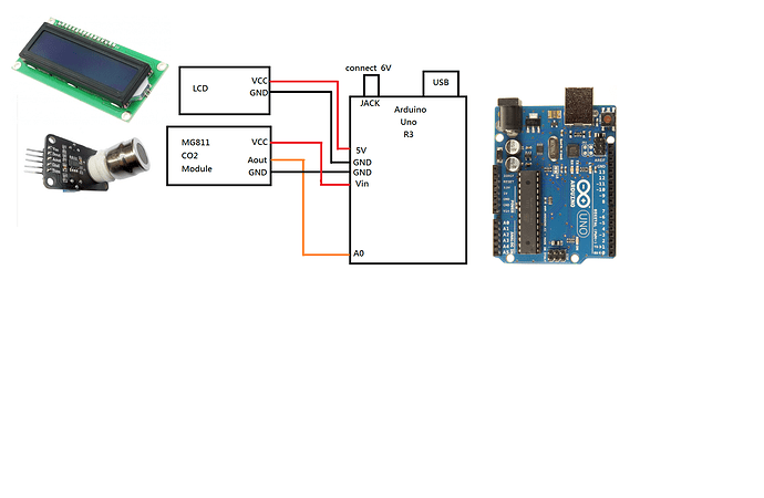

recently i'm building a device that monitor CO2 concentration in my room
in this device i use a MG811 module as the CO2 sensor as shown below
and i wrote some code to get the analog voltage from the sensor
the voltage displayed in LCD was very unstable
i can't find obvious change while i exhale the sensor
initially i believed it resulted from unstable output of the sensor
but when i tried using a Fluke multimeter to test
the reading on multimeter was very stable
and the voltage changed as i exhale it
i had a wrong wiring or codes?
plz help

That schematic! Not very complete is it. How does the LCD get data? Telepathy?
Try increasing this valueint times=1;to perhaps 20?
have you ever used the MG811 sensor?
i'm curious whether the analog output of MG811 is essentially slightly unstable
or my Arduino get a wrong signal
if the signal is valid but slightly unstable
taking many samplings and calculating the average value may solve this problem
Making the code change I suggested will take 10 samples and average them. Your multimeter is in effect also doing this. I have never used this sensor, but I have used other types of noisy analog sensor. I normally use a "first-order filter" technique in my code to smooth the reading.

Your suggestion worked very well
The output improved significantly.
The fluctuation reduced from over 100mV to just several mV
Despite it didn't work better than multimeter(below 1mV of fluctuation)
but I believe it's practical enough
