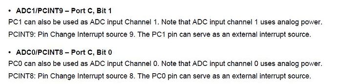

"analog pins" are digital pins that are also connected to the internal analog to digital multiplexer. You can use them like any other digital pin. You can even reference them as digital pins 14 to 19 if that helps make things more clear in your code. (A0 is 14, thru A5 is 19).
Looks at their description in the data sheet - analog input feature is not even mentioned to start, not until much later.
All pins on a UNO are identical digital pins. Pins 14 to 19 happen to have the additional ability to be used as ADC inputs. Pins 18 and 19 (Also Known As "A4" and "A5" of course) have yet another available and very important function, as they connect the hardware I2C interface.
The Nano and Pro Mini, using a different package of essentially the same processor, also make available A6 and A7 which are only ADC inputs with no digital functionality. The Nano is far more practical than the UNO for most purposes. The Pro Mini is of course, when you do not need USB.
