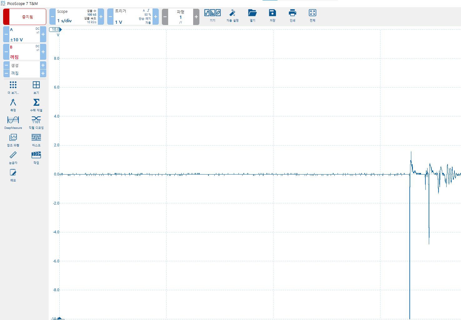

Hi everyone,
Can an Arduino handle analog impulse signals where the peak voltage is 10V? I have done some research on the forms and found that Arduino's maximum input voltage is 5V but I thought maybe they can handle impulse signals because they do not have much current going through. Like how lightning and sparks both have high voltages, but sparks are harmless due to the low current.
I have attached a picoscope file of the sensor output. You can see that the peak is over 10V, but the duration of the peak is extremely low.
If the Arduino cannot handle such signals, what kind of microcontroller board or SBC would be suitable for such sensors?
Thanks!
No, you should never expose any microprocessor input to more than 5volt (3.3volt for the newer 3.3volt-logic processors). And the peaks are negative, so 0.3volt is the limit there for all processors.
There are solutions, like voltage dividers and/or clamping diodes.
To advise you there, we have to know what are you measuring.
Leo..
A voltage divider (2x10K resistors) will reduce a 10V peak to 5V, and for somewhat higher voltage pulses, will protect the input from damage.
If there's actually something limiting the current, right. The voltage will drop (Ohm's Law) and the high voltage won't exist..
A 10K series resistor may be enough to protect the Arduino because the "regular" Arduino (ATmega chip) has "small" protection diodes on the inputs connected to Vcc and ground so when you go about 0.5V above Vcc, or about 0.5V negative, those diodes conduct, limiting the voltage. But I believe they are only rated for 1mA.
Or, here some external protection circuits. (You can increase the current limiting resistor to 1K or more.)

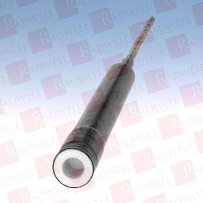

The sensor is a FMX2 0-10bar Endress +Hausserr water pilot, I use a signal conditioner to convert its 4-20mA output to 0-10v. I had them to hand. If I was buying parts I would have selected a water pilot that read 0-2 meters because my tank is less than 2m deep. If I recall the signal conditioner is Marposs branded, I wouldn’t be willing to put money on it without checking.
And yes, I know water pilot suggests water, mine has worked fine in oil for a few years all the same. Specific gravity or kerosine is 0.8 and water is 0.981 so you just have to change the calibration ratio.
This is the sort of thing I use. The link is a 0-20bar sensor when mine is 0-10 bar.

Not only is it over 10V it is also negaive, a double whammy for any microcontroller.
You will need to do some analog conditioning of that signal before you can do any processing with a microcontroller.
Exactly what about the signal are you trying to measure?
